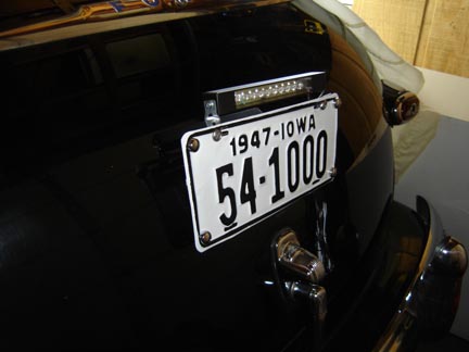

I found that the simplest, and most effective solution to dim stop and turn lights is the LED light bar. I mounted mine on top of the license plate, but they come with a suction cup to hold them in the back window. Anyone contemplating converting to LEDs for turn signals should know that, in almost all cases, additional resistance must be added to allow the flasher to operate properly.
