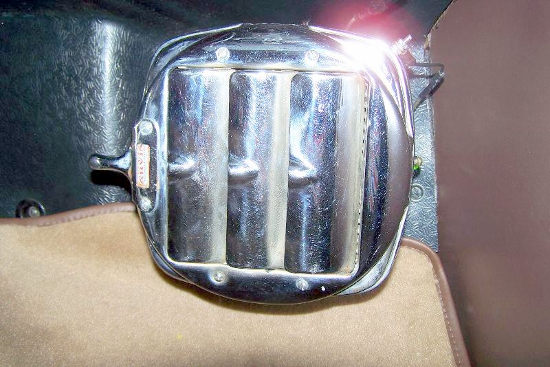

  I have an Arvin hot water heater in my '35. I found that if you bolt it on top of the insulator pad it will crack and rip the pad and not be securely held to the firewall. I suppose cutting out an area and bolting it to the firewall would work. Kinda crude but should work.
However, what I did was remove the insulating material on the backside of the pad cover where the heater was to be mounted. I then glued a piece of wood to the firewall that was the same thickness and shape of the of the insulating material that I removed.
The result - The heater is mounted firmly to the firewall (via the wood) and did not alter, damage or distort the pad cover.
Hope this helps.

  Ford used standoffs over the bolts to install the heater in 1939 and 40. This prevents cracking the insulator and give air space behind the heater for better air flow.
drkbp    -- 04-23-2012 @ 6:26 AM
  I had a Southwind gas heater in my '35 Cabriolet when I got the car. The stand off washers that hold the firewall insulator were used with a little part TomO must be talking about to hold the heater just slightly away from the insulator. I left the heater out when I redid the car 35 years ago.
