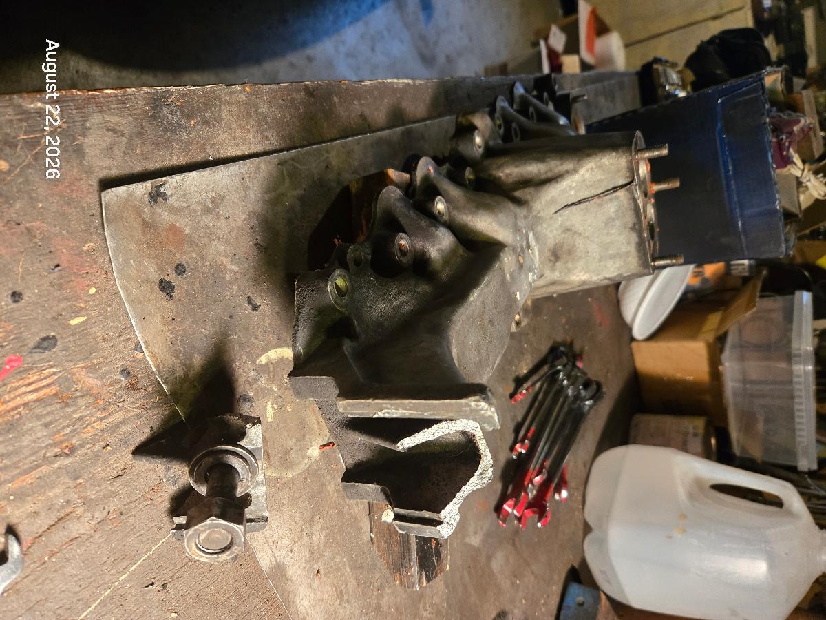

I just had the front of my intake manifold which holds the generator, break off. The generator went wild and sliced a 4" gash in the hood and totaled the radiator. It looks to me like a stress fracture in the aluminum manifold casting. I am wondering if anyone out there might know if there is any history of this event ever happening to aluminum manifolds. Also, I am looking for a new manifold. I am hoping, that with all the conversions to two and three carb manifolds, there are a bunch of originals around. Any any leads would be appreiated. Also, any information on new radiators woujld be helpful.

  Sorry about that-it is a 1935 ford. Also sorry about the dis-oriented picture.

  There are two different intakes for the 35. An early and around 3 to 4 of 35 a later that appears like your broken manifold. The early requires a different length fuel pump push rod. The front of the early intake is much different than your broken intake. Suggest getting the V8 club 35-36 restoration book it shows both intakes.

  If you are unable to find a suitable replacement manifold, perhaps you can find someone capable of welding your aluminum manifold to restore it to a condition as good as or better than new.
