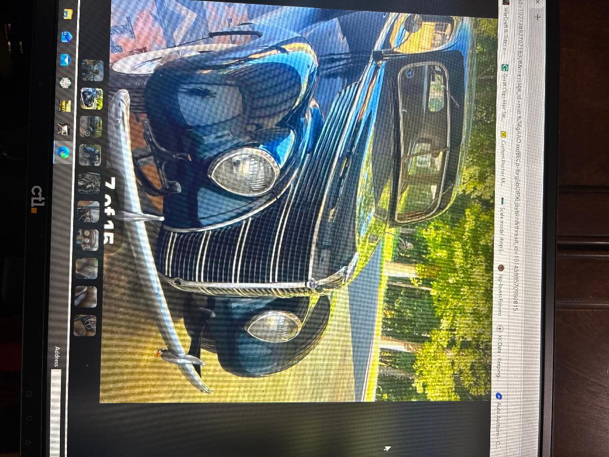

  Recently acquired a survivor 1938 Tudor 64,k I believe it's a standard with 85 HP engine. Other than mechanical I plan to leave it with its original patina. Just completing installing new kingpins, drag link, and tier rod ends. And steering box adj. Upon advice, I am installing the John Deere green grease to the steering box. The brakes look to be somewhat modified as the original adjusters were replaced with a wheel-like part that I presume you adjust with a small screwdriver for the outside of the backing plate. I am wondering if this is a floating shoe now. ?? I will try to post a pix of the brakes.

  Congratulations on acquiring such a beautiful car! You're fortunate to have the '38 Standard Model, which is a much more beautiful design than the Deluxe Model...
