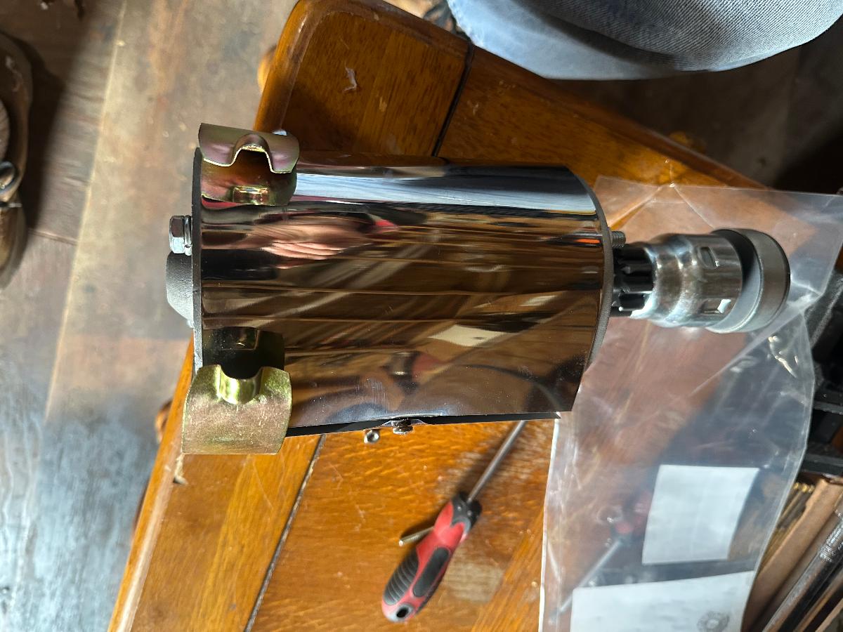

I’ve been battling heat soak problem with my ‘51 starter for a while. I finally bought a new one to run while I rebuild the old ones. I also bought this fancy heat shield. As I’m putting it on it looks to me like this thing would trap more heat then it reflects. Have any of you ever had any experience with this kind of shield? I’m thinking it might be better off this wrapping my headers. They run very close to the starter. I bought the shield from Speedway. It’s no great loss. If I don’t need it I’m sure I can find a home for this piece of stainless steel.

I don't mean to be critical. but you might receive better support if you continue postings on the same thread, rather than continually starting new ones. You have had multiple threads on this or a similar issue. You already asked about this shield back in February and received a good response. Ken
| kubes40 | -- 03-22-2026 @ 11:53 AM |
I must agree with Ken. I will reiterate in part my response to you a while back... if you wrap the starter, that wrapping acts as an insulator. In other words, the heat soak will be worse. A heat shield will allow a space for air to circulate between it and the starter. I can't grasp how wrapping the header would help. other than perhaps the wrapping may serve as a heat shield in some minute fashion. Mike "Kube" Kubarth

Wlobb, from the photo to my eyes, it appears that shield will wrap the starter. If so, not a good plan. Mike "Kube" Kubarth

| TomO | -- 03-22-2026 @ 3:08 PM |
When you update a post, it goes to the top of the list and gets bumped down by later posts. So no matter how long ago you started a post, answers and updates will be current. The purpose of a heat shield is to reflect the heat away froom the starter. So it should be as close to the heat source as possible. Tom
| carcrazy | -- 03-22-2026 @ 5:11 PM |
Wrapping the exhaust header where it passes near the starter motor will most likely cure your problem. Speedway Motors and others offer exhaust wrap kits.
| woodiewagon46 | -- 03-23-2026 @ 7:54 AM |
In the hot rod world there are several companies, Design Engineering Inc. and Heatshield Products just to name a couple, that make products specifically designed to insulate vehicle starter motors. They are flexible and attach with velcro so they easily removable. I would hesitate to use that stainless steel cover you purchased.

| TomO | -- 03-23-2026 @ 11:18 AM |
How close to the starter are your headers? If there is a couple of inches of clearance, you should not need a heat shield. I have about 1" between my headers and the starter and do not have any problem with heat soak. Tom
| kubes40 | -- 03-24-2026 @ 10:41 AM |
TomO has offered great advice. Wrapping the starter will not help at all. In fact, it will hinder. Mike "Kube" Kubarth
| woodiewagon46 | -- 03-24-2026 @ 11:52 AM |
I suggest you read up on what causes "starter heat soak". Excessive engine and engine compartment heat is the cause of heat soak. Insulating your starter with the proper insulation material designed for this purpose will help your problem. If in fact your exhaust pipe is very close to your starter, then insulating the pipe near the starter or using a heat shield between the pipe and starter motor will also help. You mention "headers, has this car been modified?
