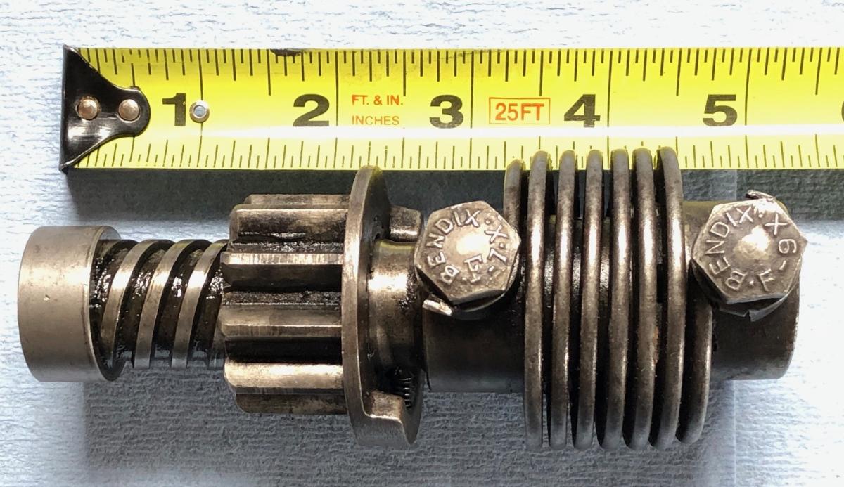

The"noise" and thud after the "not easy to get in" tells me that your Bendix spring is misaligned , engaged and binding on the flywheel gear. Before removing as advised above, try loosening the bolts one turn each, and giving the starter a good solid rap with a mallet. If that results in a "noise" and a bit looser, tighten the bolts and give it another try. One additional point to check, be sure that the front clip mount to the oil pan is in place, or the Bendix is likely to bind up again. Alan This message was edited by ford38v8 on 2-25-26 @ 7:43 PM
| 51woodie | -- 02-26-2026 @ 2:35 AM |
Alan, I have changed the starter on my '46, 59AB, and had no issues. What do you mean when you posted, the "Bendix spring is misaligned?
