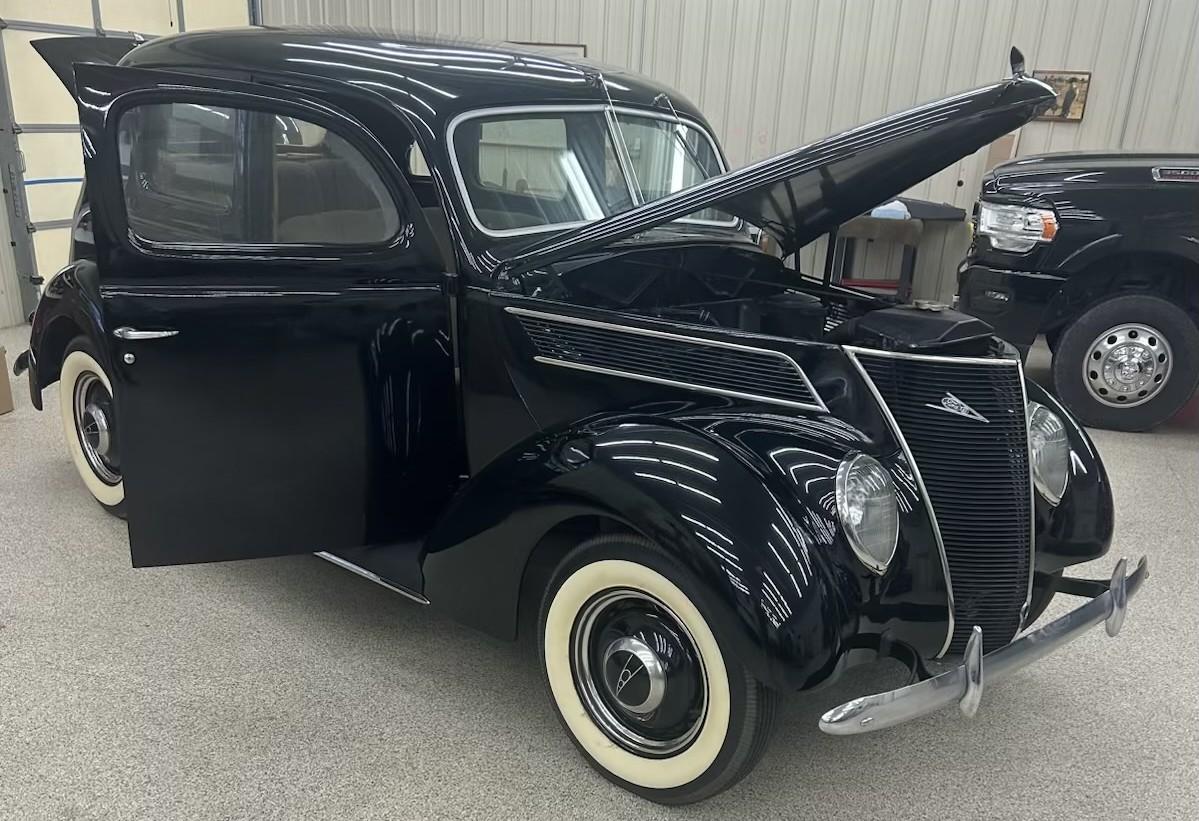

I have replaced points and condenser on several Model A and set the timing and am pretty good at most mechanical things but have never messed with a "helmet style" duel point distributor. Does anyone have a resource of information or suggestions on where to get a good set of Standard Blue Streak points and Condenser (if they even exist?) . Or should I just send the whole helmet distributor and coil out for refurbishment, ever herd of a place called, "George (Skip) Haney Coils and Pumps?
