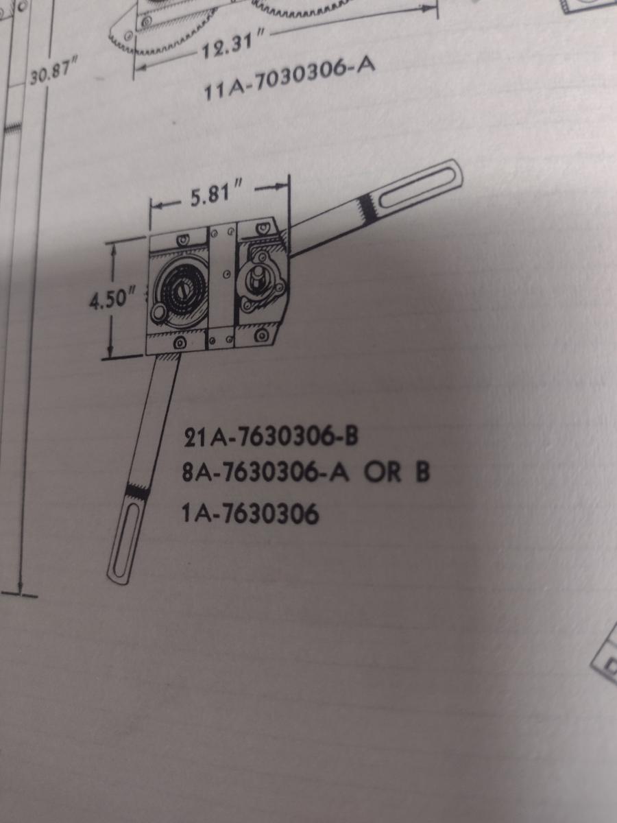

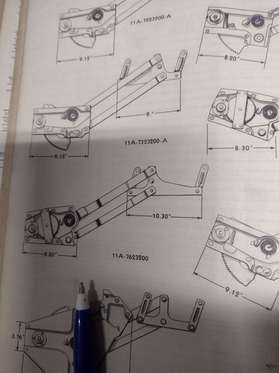

  I am looking for the OEM part numbers for the front and rear window regulators for a 1948 Ford convertible model 89A-76A. It would also be helpful to have the line drawings for these items if they are available.
Thanks for any help you can provide.

  Front regulators are P/N 11A-7623200 RH and 11A-7623201 LH. The 11A prefix means 1941 so that indicates that 41-48 was the same. The 76 on the base number indicates convertible body type so the regulator is unique to the convertible body. The base is 8.3" wide and the upper portion that attaches to the window 10.3" wide.
Rear window regulator P/N's are 21A-7630306-B RH and 21A-7630307-B LH. The 21A prefix indicates 1942 and the 76 on the base number indicates convertible. So, on the rears 1942-48 convertible should be the same. A dimension for the base portion of the regulator is given of 5.81" wide and 4.5" high. The LH indicates it was replaced by P/N 8A-7630307-B so a 49 convertible LH regulator may work but require some modifications. I don't have a rear picture but there is a picture of the front regulator in the body parts book.

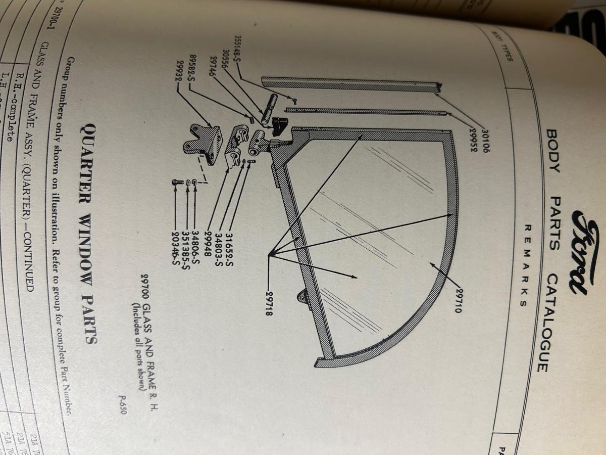

1942deluxe    -- 02-14-2026 @ 7:55 AM
  Dave,
Here are photos of the quarter regulator and the quarter window.
