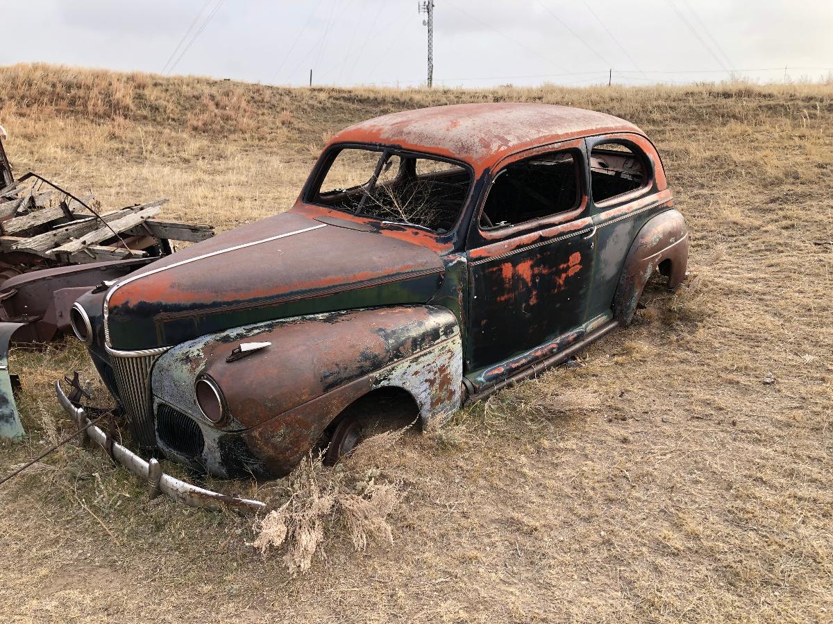

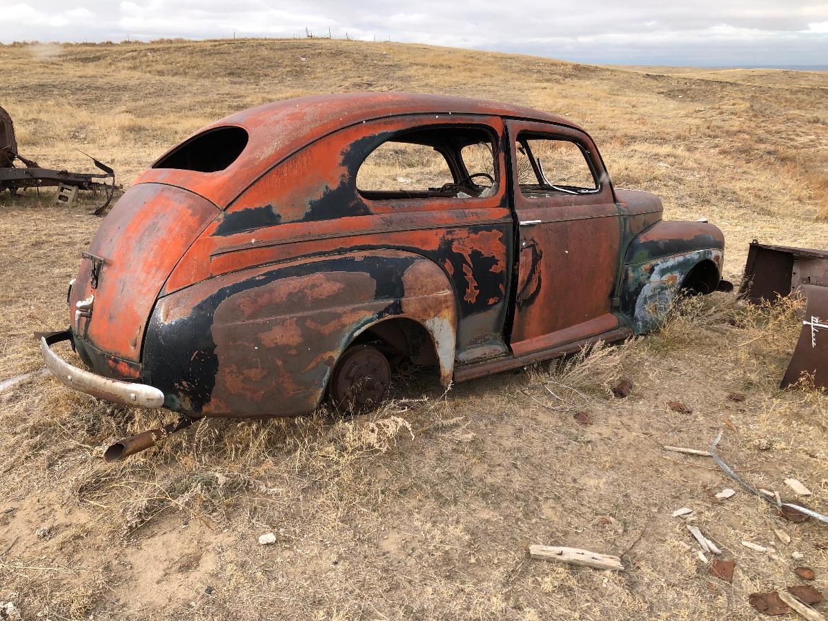

  Hello I wanted to introduce myself and my newest project, we pulled this 1941 Special out of the pasture in Western Nebraska that has been sitting since around 1955-1958 as far as anyone can remember. I've know about this car for 25 years and was finally able to bring it home with me to Alabama. (Grew up in Nebraska, retired Marine that settled in Muscle Shoals).

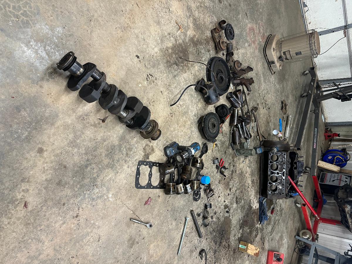

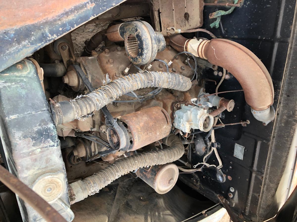

The car is complete, the engine had a stuck piston and all of the rod bearings were broken in multiple places, it looks like it was run out of oil. But thanks to the arid environment and parked on a hill in sandy soil the rust is limited to the front floor board, and the bottom of the quarter panels. The drums weren't even frozen and everything in the front end is loose. During teardown every bolt came loose like it was new which was a great surprise.

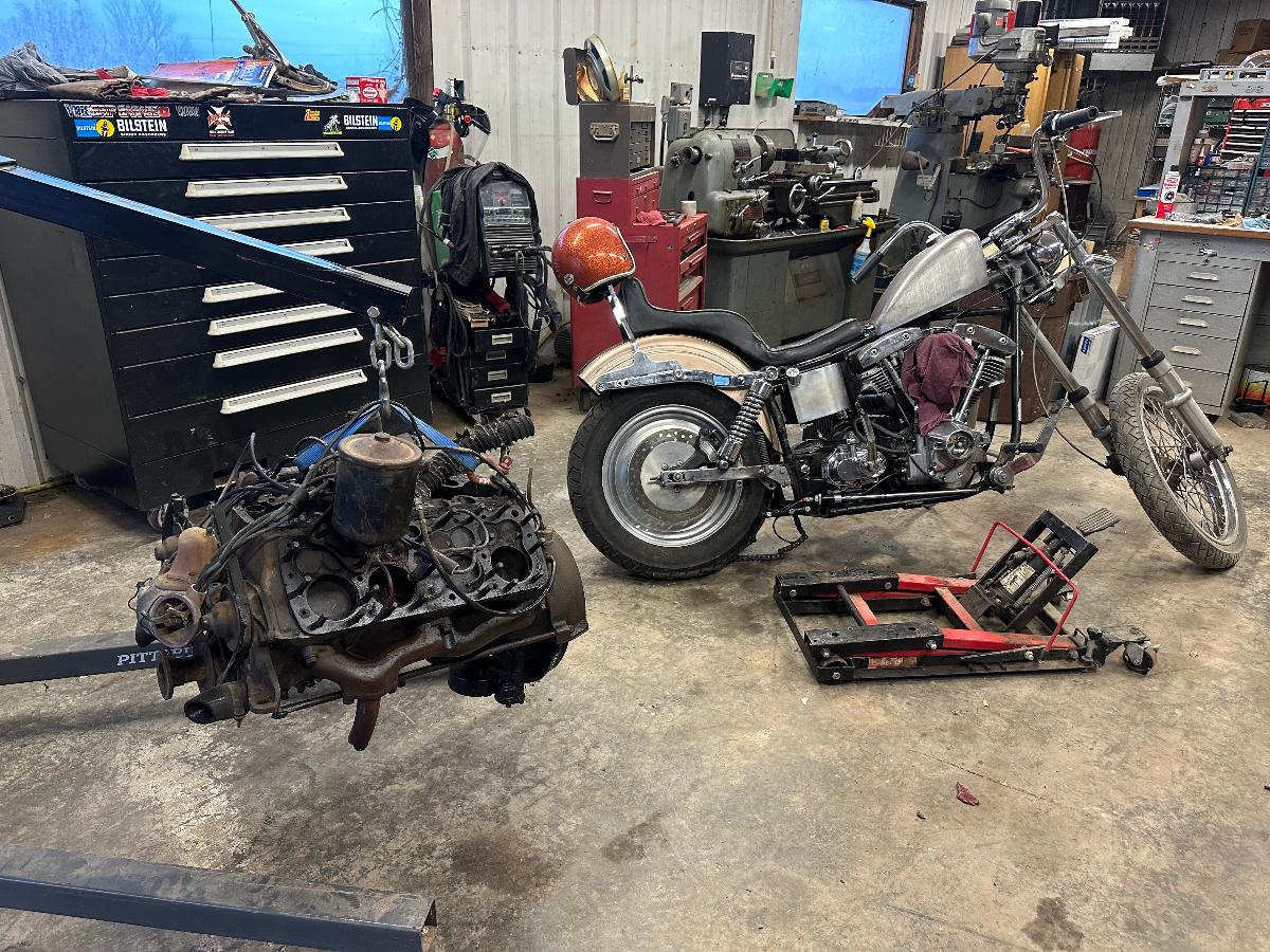

The block didn't have any visible cracks after I knocked out the liners, but I dropped it off at the machine shop today to get hot tanked, magnafluxed, and pressure tested to verify before I put any effort into it. The goal with this is to mechanically restore it as cheaply as possible, only new parts where required, bring the interior to stock or period correct'ish, clear the exterior and drive the snot out of it.
