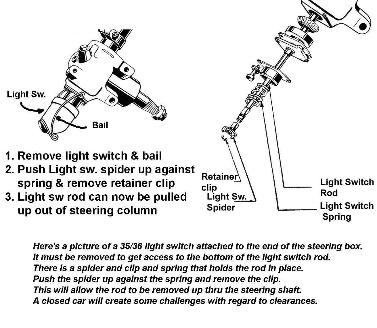

| Don Rogers | -- 08-29-2025 @ 10:50 AM |
Here's an exploded view of the lighting switch and comments. See if you have all the parts shown
