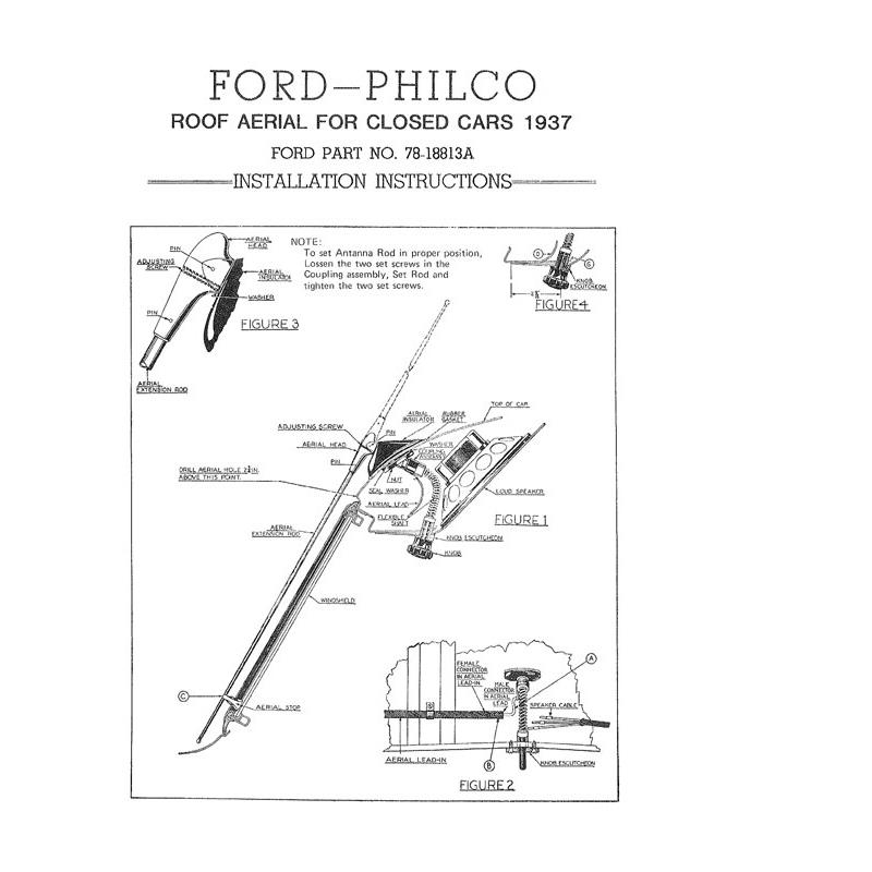

will a original 1938 sedan radio roof antenna work on my 37 sedan
| MG | -- 07-22-2025 @ 3:43 PM |
Yes, if it's properly installed...
| tk1062@aol.com | -- 07-22-2025 @ 6:01 PM |
Does it have to be modified ? Or is it the same antenna kit thanks
| MG | -- 07-22-2025 @ 9:37 PM |
There are deferences... 1938 diagram- https://cgfordparts.com/radio-antenna-assembly-38-coupe-sedan-roof-mount-81a-18813-a.html 1937 diagram: This message was edited by MG on 7-22-25 @ 10:58 PM
