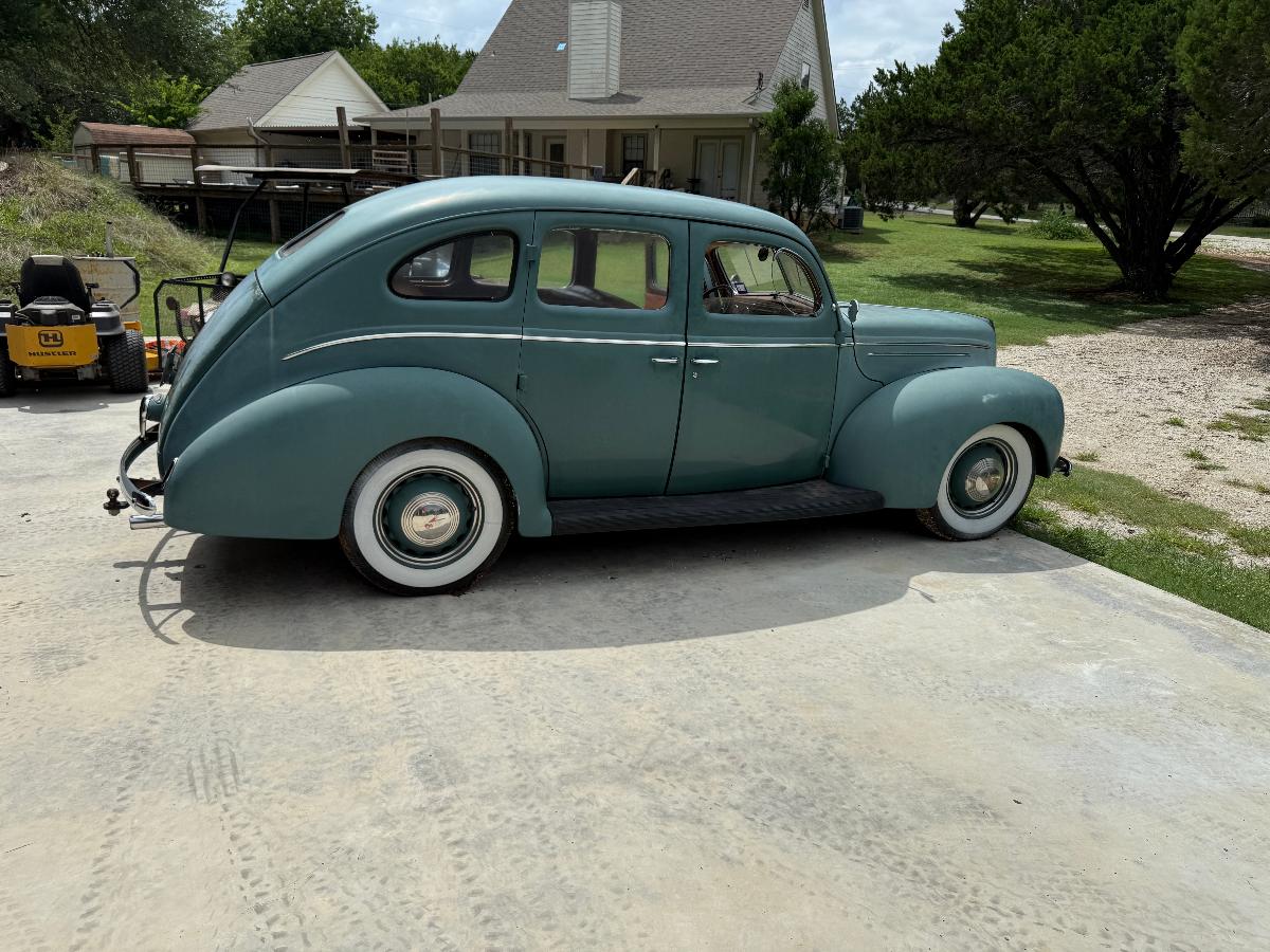

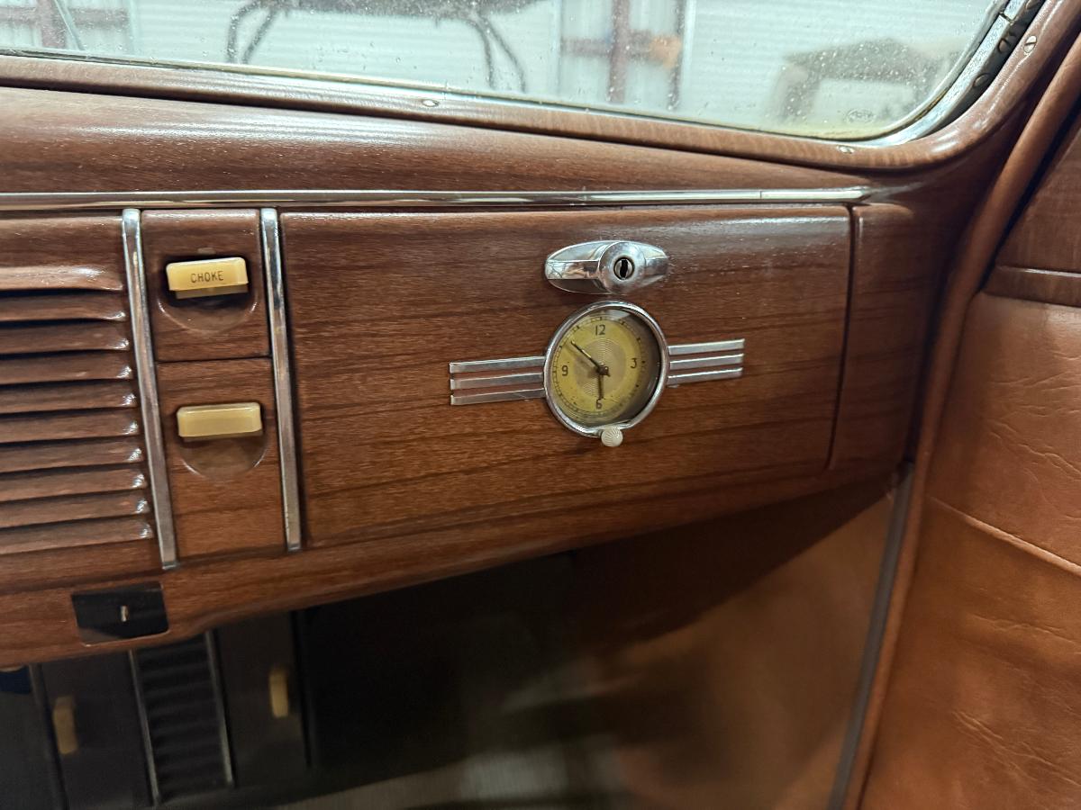

New to me today , just titled, brought home yesterday. All original factory everything , clock on glove box , extremely clean! Hasn’t run since 2021 and had problems then. My friend aged up and is now in the Lords hands. His last couple years he didn’t give me much to talk about when we visited we just sat around listening to me talk. Today I tried to charge the battery that is of 2020 and I just realized I hooked it up backwards. I saw the ground cable to the firewall( yes I know now it’s a positive ground ) and just out of normal practice hooked it up backwards for almost 10 minutes. I had a volt meter on looking for any signs of life when I touched the ground clamp and it was warm. I disconnected and figured I would just get a new battery ( 6vdc). Now I know what I know , how much damage have I done. May I have fried the generator, clock, points condenser …… ? Any help from you experts would be greatly appreciated as I’m a COMPLETE NEWBY to this awesome flathead. All my past experience is with SBC and BBC’s. Bit my friend wanted me to have his horror as he called it, so me and the family will get this running and remember him on our Sunday cruzes. This message was edited by Statewurker on 7-7-25 @ 4:33 PM

The clock is a wind-up. Power wire to it is for the light.
