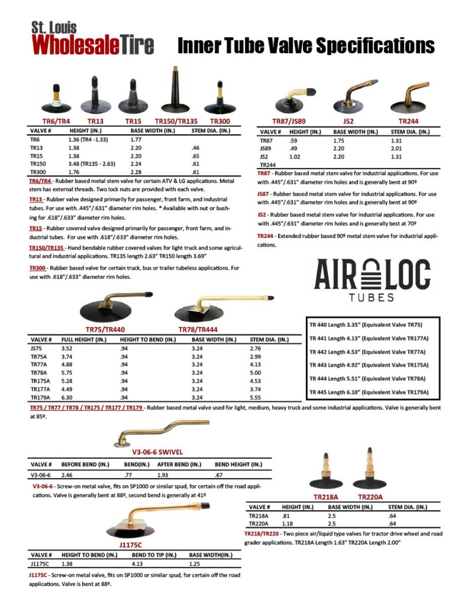

Which tubes would I use on stock 1936 16" tires. TR13 or TR15. Tires are 600-16

From Mr. Google: The primary difference between TR13 and TR15 valve stems lies in their base diameter and the corresponding rim hole size. TR15 stems have a larger base diameter and are designed for larger rim holes (typically around .625 inches), while TR13 stems have a smaller base diameter and are designed for smaller rim holes (around .453 inches) ______________ No signature

I know the difference is in the diameter of the valve stem just wanted to know which is correct for stock 1936 rims

My stock 1937 wide five rims have the larger valve stems on the tubes, they measured above 1/2” in diameter, closer to 9/16” to 5/8”. These tires were mounted back around 1967, so they have been on awhile, haven’t been on the road since 1971. I hope this helps you make a decision.

The tubes that Universal Vintage Tire put in my 600-16 bias tires on my '46 Coupe, were listed on the invoice as; "KR-16 600/650R16 TR15 Radial Tube".
| Bob56 | -- 07-09-2025 @ 2:56 AM |
Thank you. That is what I was looking for
