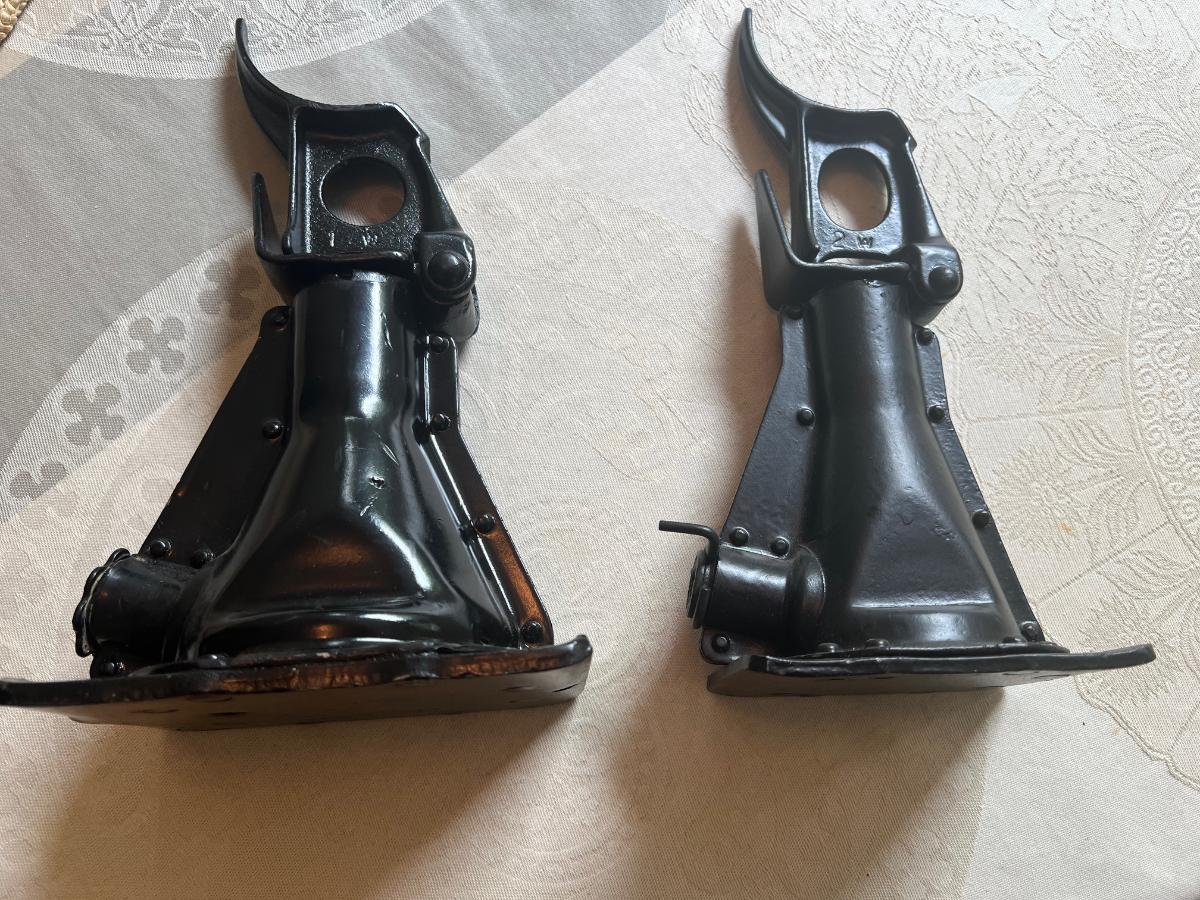

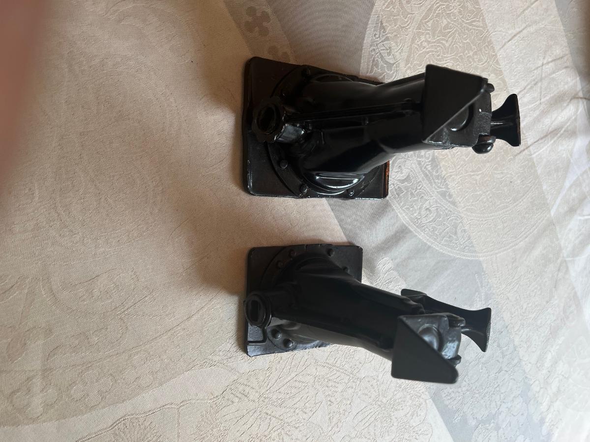

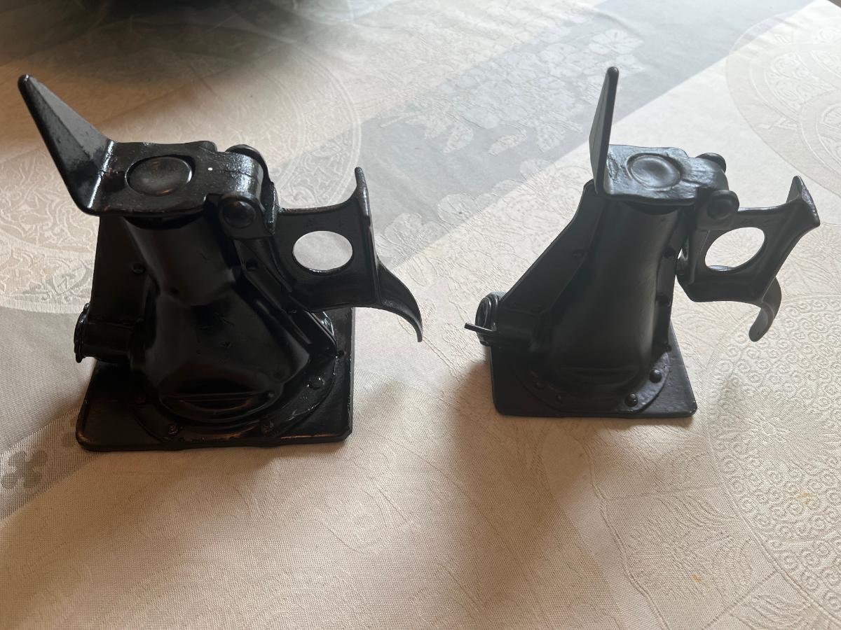

  These two jacks came with my 1941 Ford 1/2 ton pickup. Neither was correct for the truck. With help on this site, I've found the correct jack.
So which car might these fit? The design is the same, but the size is different, although both are 10.25" tall.

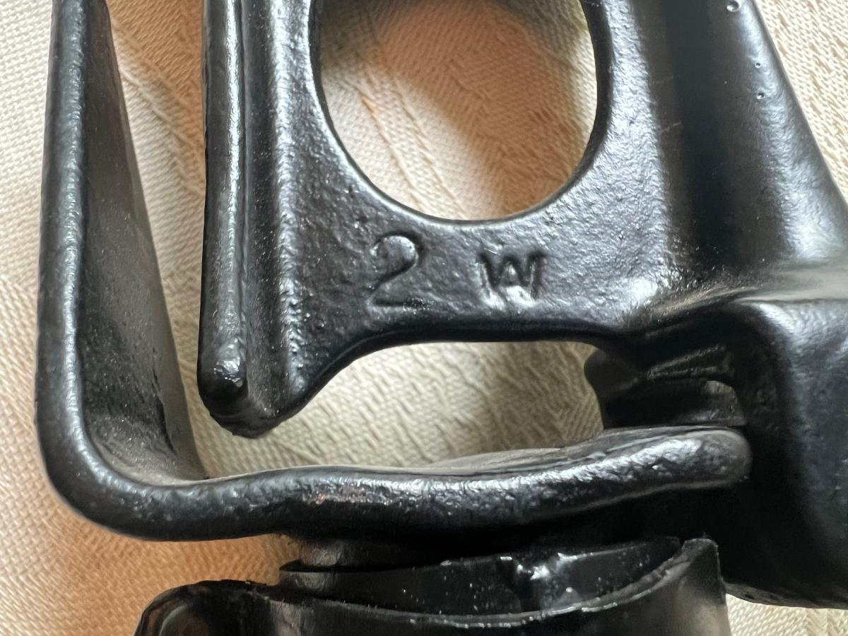

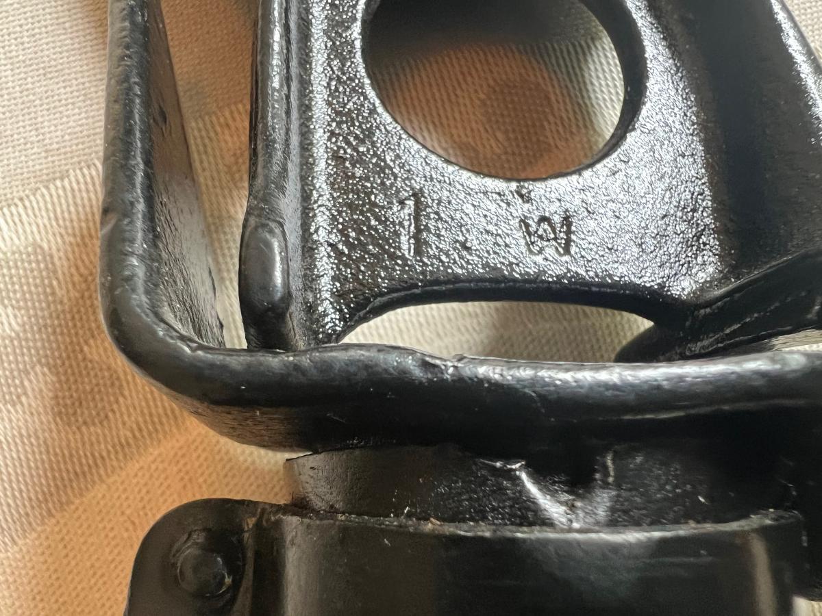

The larger is marked 1 W with a 6" X 4.25" base. The smaller is marked 2 W with a 4.5" X 3.5" base. Each base has a small hole at the bottom of the spine.
Any ideas as to one or both and the cars/trucks they fit? They are in excellent condition. Your help will get these to the right vehicle.
v8er    -- 06-12-2025 @ 4:30 AM
  The larger jack is likely for trucks larger than pickup. The smaller jack is likely for car and pickup and appears to be for '35 and '36.
