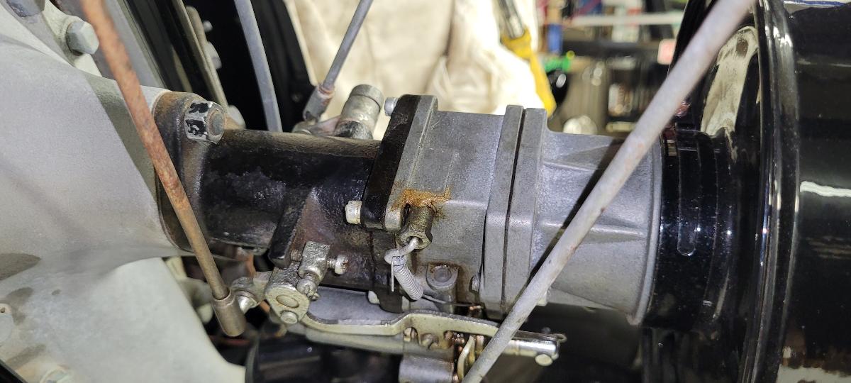

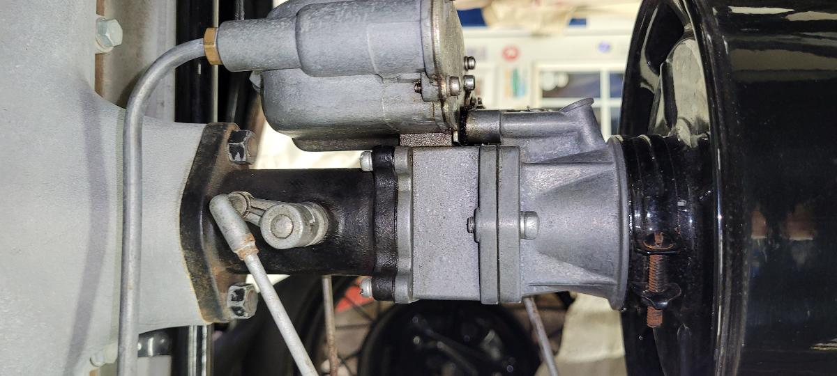

  I got my 1933 wagon running but I want to lean out the mixture. Are there instructions somewhere on how to adjust the carb? thanks
40 Coupe    -- 04-30-2025 @ 5:54 AM
  Ford service bulletins, Remove the air cleaner. The T shaped pin at the top center of the Carb. is for idle fuel adjustment. CW for leaner. This adjustment is not like adjusting a 97. The basic adjustment is about 5+ turns out so don't try to bottom out the pin just make small adjustments from your existing setting until you get smooth idle.
