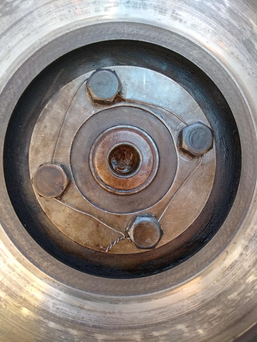

I removed the pressure plate for a new 9" clutch and anticipated removing a bronze donut pilot bearing. That isn't what I found. I removed one of those solid bronze pilot bearing a few years ago by packing the bore and cavity with thick grease and hammering a taped bolt through. It popped right out. Not today and what is in there appears to me to be as sealed bearing, so I'm tempted to leave it although I would rather replace it. This car had not run since 1956 when I bought it in 2008. Can anybody identify what I have in there? Thanks!

My gosh man, replace it. I'd not think twice about replacing a ten-dollar bearing vs. taking that apart again when it fails a month from now. I am 99% certain that bearing is identical to the front generator bearing. Once you remove it, there will be numbers on the sh*ll to positively identify it. Easily cross referenced if need be. If you can't read the numbers, let me know. I am quite certain I have listings. Mike "Kube" Kubarth

Try the grease trick on this bearing too. If that doesn't work, then you can use a slide hammer or a small gear puller to pull it out.

hi that pilot bearing should be from 1928 to 1948, so any vintage parts vendor should stock them, part number 7600 GET THE ONE with 2 shielded sides on the ball bearing, hope this helps, 37Ragtopman,Maine
