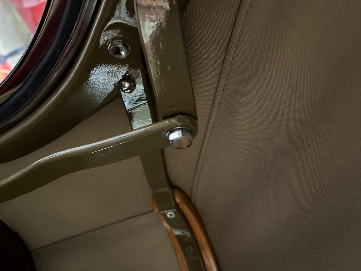

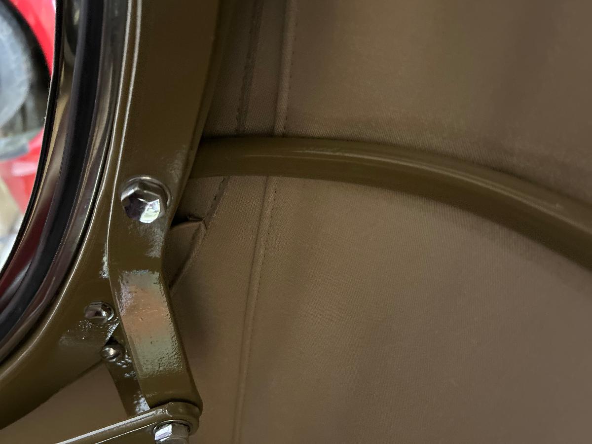

  I have the bows but am uncertain where the 2 rear bows (one metal/one wood w metal arms) should be mounted, I've purchased 3 different books but none show the bows??? Any pics would be appreciated!!!
trjford8    -- 04-15-2025 @ 2:13 PM
  The metal one with the wood goes to the rear.
NGABronco    -- 04-15-2025 @ 4:52 PM
  Yes sir, but does it hinge in front or behind the all metal bow? There's 3 bows, short one in front, then a taller metal bow, then the wooden bow. If I mount the wooden bow in the last possible holes, the top doesn't want to lay down, too long to go in the boot?
flathead48    -- 04-18-2025 @ 2:34 AM
  Hope this helps
NGABronco    -- 04-18-2025 @ 5:27 AM
  flathead48, thank you sir!!!
