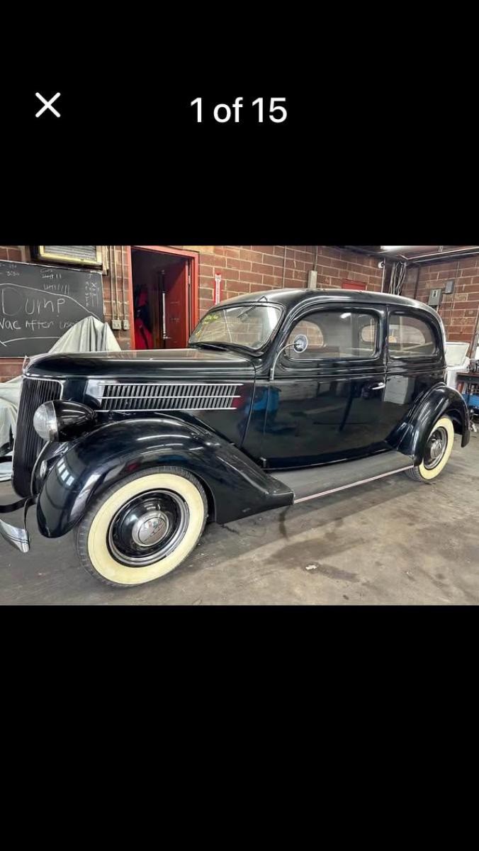

I recently purchased this 36 Tudor. It was restored in the mid 80's. A few things changed such as it appears to have a 38-40 model engine, battery relocated to the R/H side of firewall and a starter button rather than the foot button and a plastic fuel tank. Other than that it seems like it has what it should. The previous own added it to his collection in 1987. It was run periodically up until about 10-12 years ago. Always in a climate controlled setting. They ran the gas out of it before letting it sit. I got it running the other day. I removed and cleaned the tank, lines, carb and replaced the fuel pump diaphragm. I also replaced the dist with a 6V E-fire. It had no spark and although I've been messing with cars for more than 55 years now i never saw anything like the Helmet dist. I've moved on to the brakes now that it runs. Want to keep the mechanical so the questions I have for that will be in a new post. Anyway I have a few of I'm sure what will be many questions as I good alone. I live in western NC and bought it off a NC dealer. However has a VA title and will need the VIN inspected by a NC DMV inspector. I believe they need to verify two matching VINs. I purchased your 35-36 Ford Book which I find is more helpful than the 32-41 Ford/Mercury Shop Manual. In the book it give three locations for the Vin. I found the one on the top of the frame rail in the engine bay. Can the other frame rail VIN be seen with a mirror if cleaned or is the body in the way? Also the book says the VIN on the trans is stamped just above the inspection plate. I assumed the inspection plate would be on the side of the trans but don't see it. Is the inspection plate the top cover with the shifter? As for literature I have your 35-36 book which is great. The 32-41 shop manual which I believe leaves a lot to be desired. The 32-36 Engine & Chassis manual and the owners manual. Any other must have books you'd recommend for the do it yourselfer? Thanks Rob

Thanks. Judging by the grease and grime build up on the transmission it may be original to the car. I hope the inspector is satisfied with one frame number. The carpets are glued down well. Hate to ruin them getting at the cover bolts.
