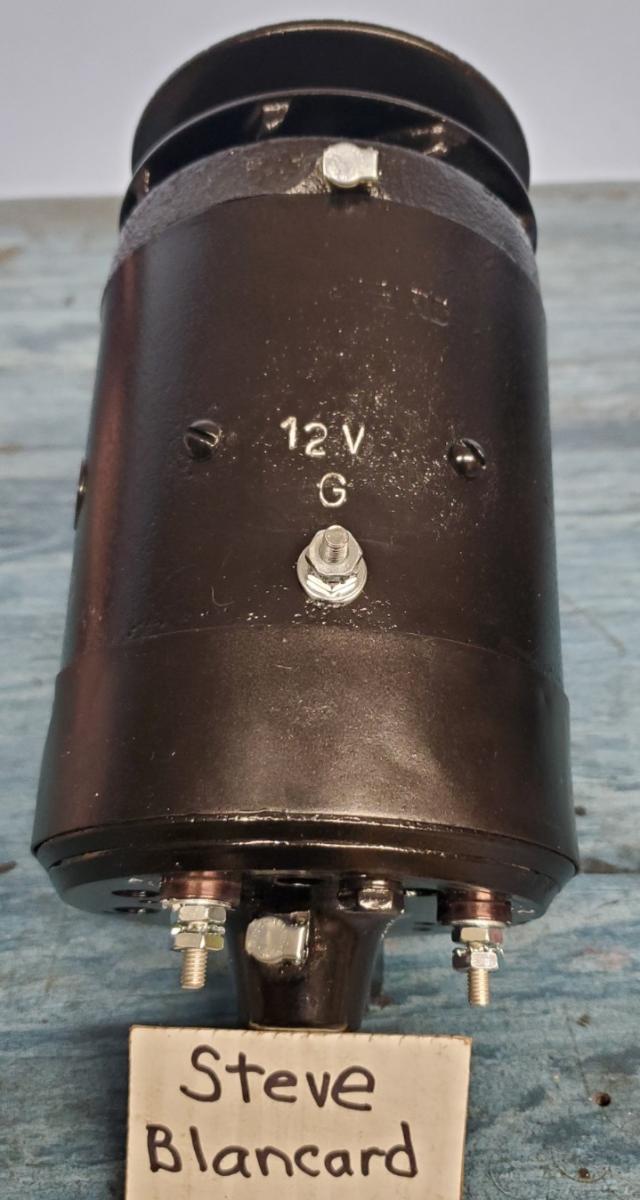

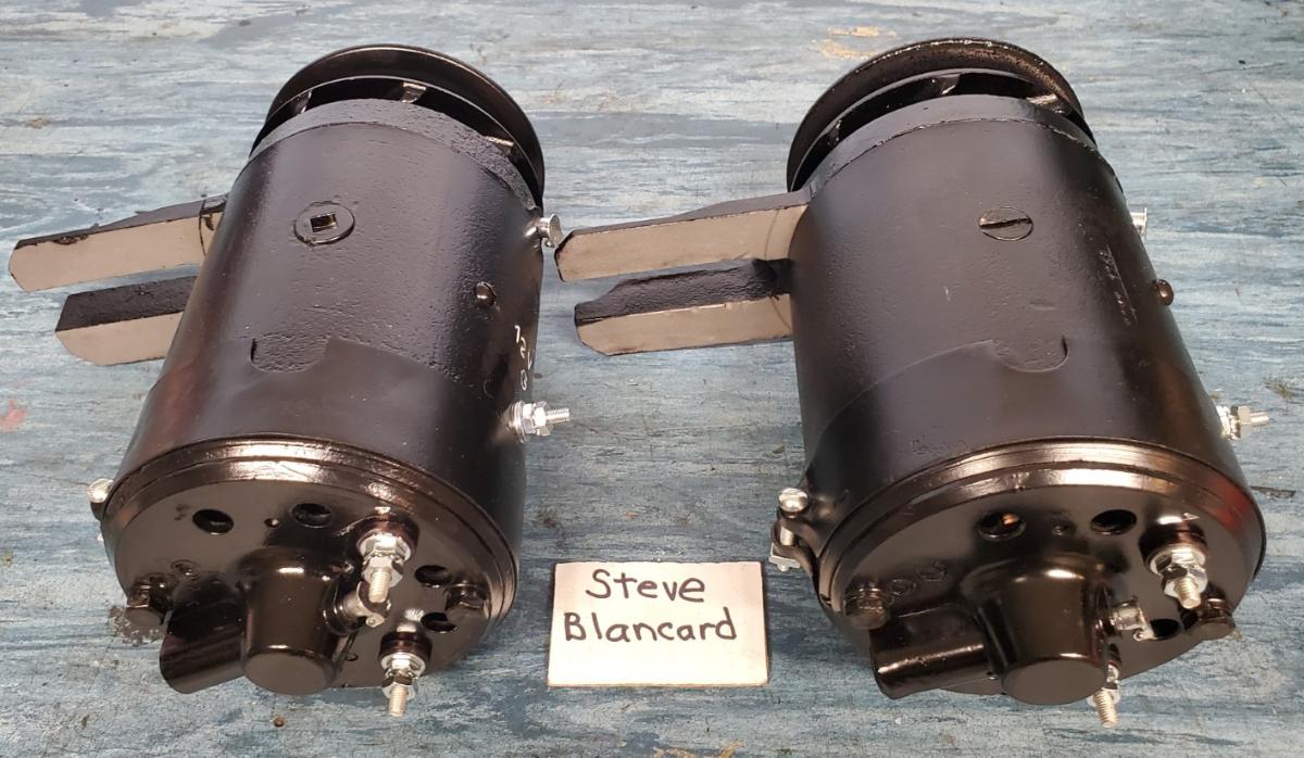

| ndnchf | -- 03-20-2025 @ 1:14 PM |
This discussion is timely. Today I finished two 1933-1837 generators. Both are 12 volt negative ground 2-brush conversions. They have "B" circuit field wiring, intended to be used with a 1955-1964 Ford 12v regulator. They cannont match the current output of an alternator. But for someone who wants a 12v system that can stil run the pulley mounted fan, this type of set up is a good choice. BTW, I use a sealed double row, angular contact bearing with custom machined spacers. These are designed to take both thrust and radial loads. Others often just use 2 radial bearings and call it good. I'll have these and other restored Ford generators at the Charlotte Auto Fair in two weeks. Steve

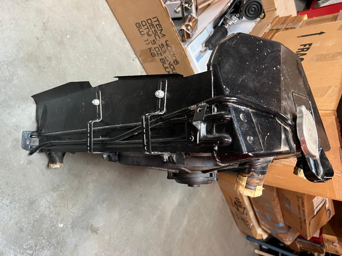

Here is the fan I will be using on my V8-60 powered Crosley. As you can see the 14" diameter electric fan is mounted near the top of the radiator as a puller to maximize cooling efficiency. Notice the steel brackets used to mount the fan assembly. This message was edited by carcrazy on 3-21-25 @ 2:32 PM
