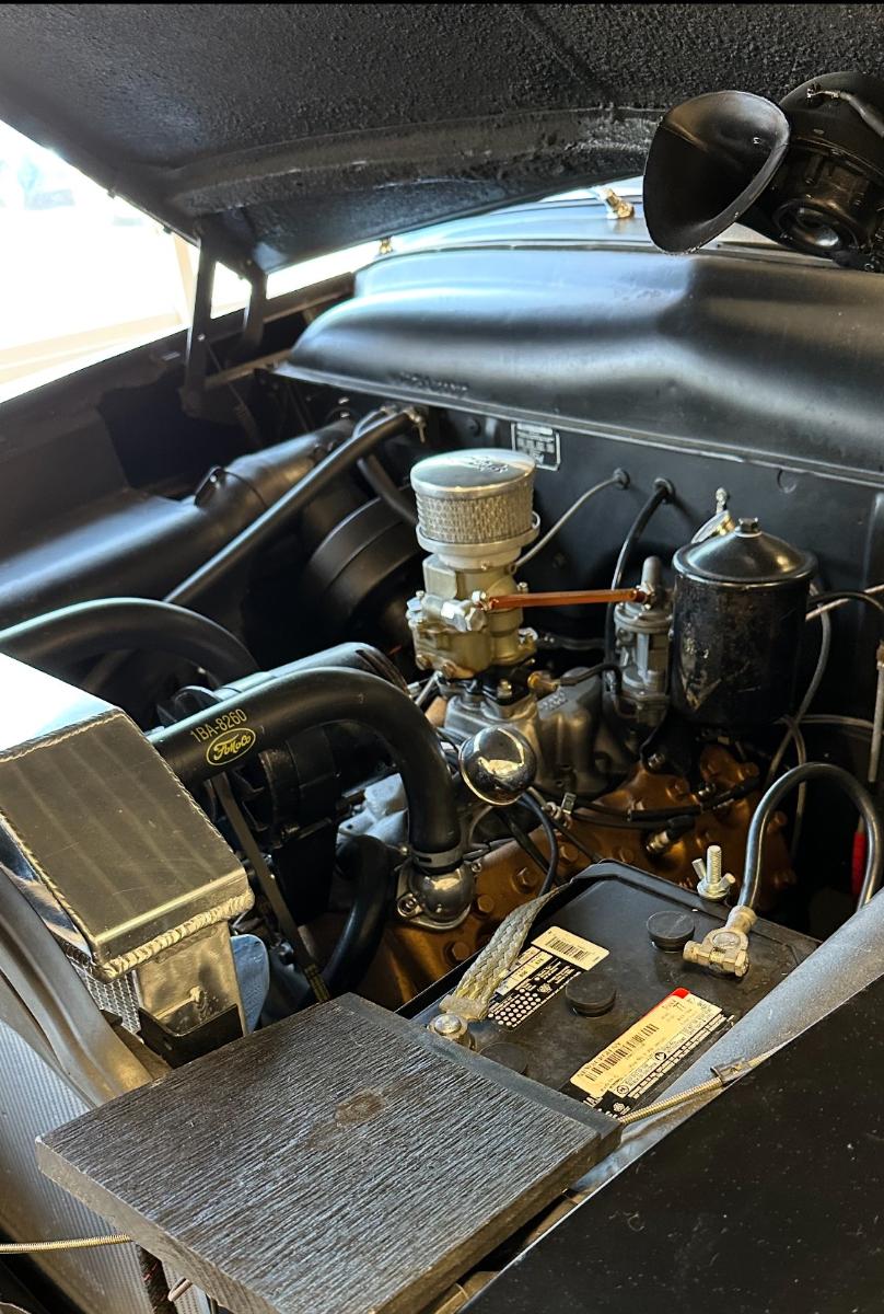

Last summer I found the love of my life, my '51 Ford Custom Deluxe convertible. When I found her, it was an abandoned mid restoration. I have been having too much fun getting things right. Last fall I got the heater blower working, only a one speed aftermarket motor, but it seems to work fine. But, I have next to no heat. I installed two 180-degree thermostats, and they hold the water temp to a solid 180 degrees.

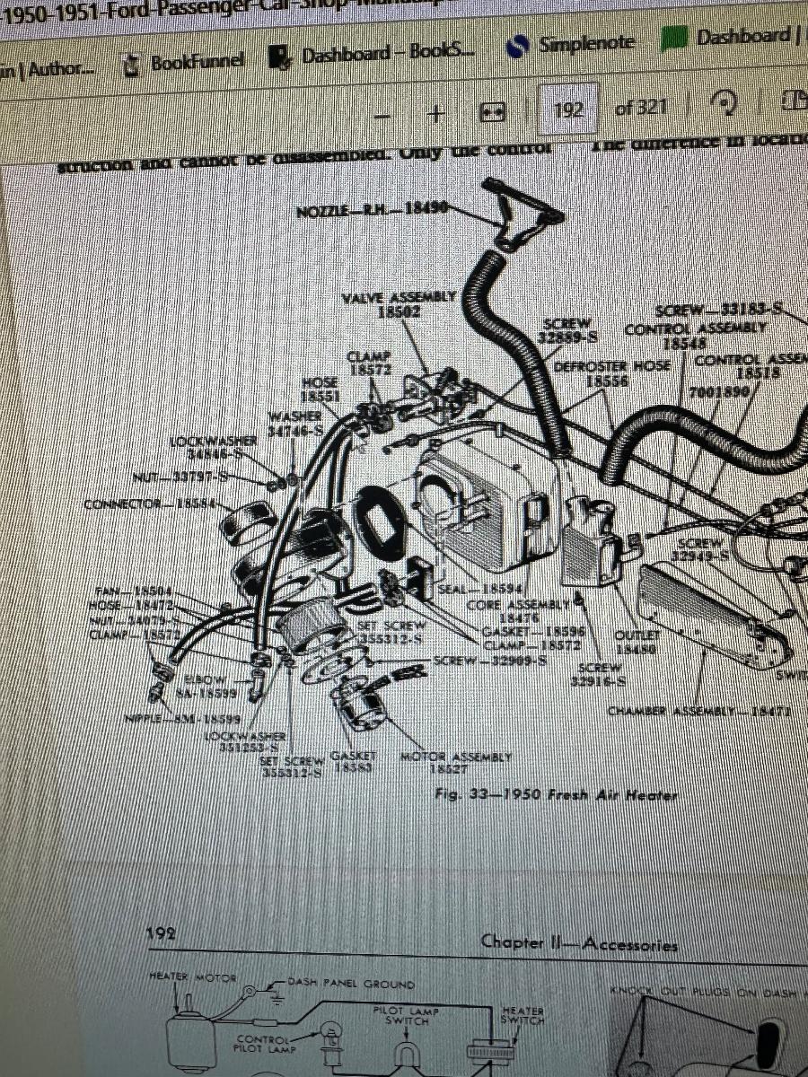

My question is the routing of the hoses form the passenger side water pump back to the heater core and back into the block. Attached is the only "schematic" I can find, from the shop manual, but it doesn't indicate what hose hooks where (block or water pump). I plan to pull the hoses and flush the core when it gets warmer here.
Does the hose coming out of the water pump go first to the valve (in picture) or does that hose go into the heater core. Right now, photo #1 (my car) shows the hose from the water pump to the driver's side of the valve and the photo from the shop manual shows that hose going to the pass side of the valve first. If anyone has any idea or a drawing of where these hoses need to be routed, I'd really appreciate it. Or, does it not matter and I'm just over thinking?

The water flows from the head into the heater.
The hose from the head connects to the passenger side of the control valve. The short hose from the right side of the control valve connects to the bottom inlet of the heater core. The long hose connects from the top of the heater core to the water pump.
The schematic can be tough to follow because of the way it is exploded, but it is accurate.
Good luck with your new love!
Ken
