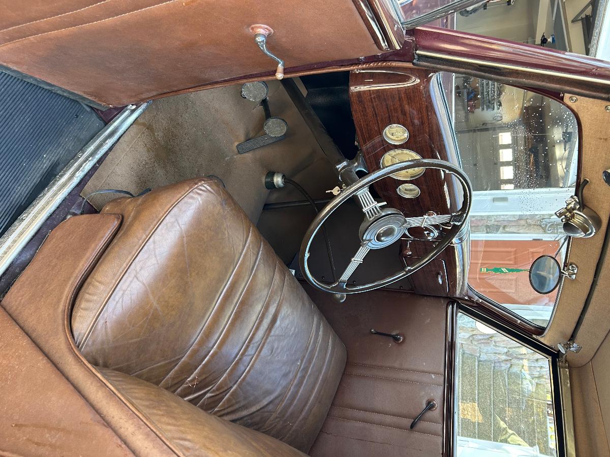

  My front bottom seat springs are completely dead on the drivers side of my 36 Conv. Sedan. (with trunk).
I would like to preserve the leather upholstery and reinstall it on new springs since it is very clean, and in great shape.
Looking in places like C.W. Moss etc. I do not see any listed for my particular car.
Many other models are listed, does anybody know if the seat springs from another model were also used in the Convertible sedans?
Thanks for any information that you can share.

  Snyder's Antique Auto Parts, New Springfield, Ohio (330-549-5313) can make any and all of the seat springs that your car needs, and may have them in stock.

  Shane,
You may very well want to stuff each coil. You will be positively amazed at the difference it will make in the seat.
I use carpet padding. Yes, carpet padding. Cut it to about 1" in length less than the respective coil spring. You'll need to figure out the length. Roll the piece up tight and shove it in the coil.
This is an old trick used by trim shops for decades.
Unless your springs are rusted away or broken, do this trick.
Oh, you also want to hog ring the coils together from keeping them from floating. Ford did this but didn't necessarily tie each coil together.

  Thank you both for the options. When I remove the seat I will check for broken springs. If it looks bad I will opt for a new set, if not I will use the stuffing the coils trick. Thank you.
