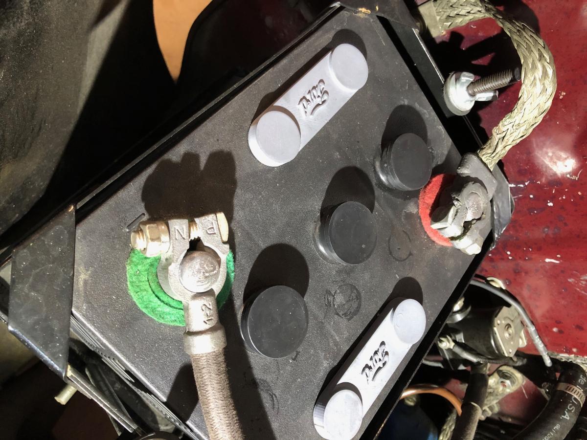

| Smittyphaeton7 | -- 12-31-2024 @ 1:38 PM |
Thank you all I’m trying the Optima Battery for now as the existing battery seems inferior. In disconnecting the cables from the existing battery the positive cable rums to a connection on the side of the axle shaft and the negative cable is connected to the starter. Are they reversed ?? She wouldn’t turn over at all if they were - correct ?? Actually, I’m probably confused. This is like a Model A - positive ground, right ? RKS This message was edited by Smittyphaeton7 on 12-31-24 @ 3:00 PM
| MG | -- 12-31-2024 @ 6:59 PM |
She would still turn over with the cables were reversed... Yes, positive ground...
