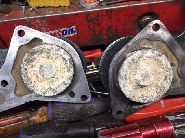

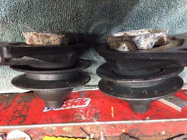

HI EXPERT. update , I removed the 2 pumps, this is what i FOUND these were put in a while back, do not remember when, maybe distilled water, water wetter and water pump did not work did I do something Wrong, ? I also bought this cleaner, it says does 12 quarts, so i need to use 1 1/2 containers to do the job,and use baking soda to neutral the coolant enclosed you will see photo's of white cake. these pumps were rebuildt , white cake from heat ? funny thing the left pump looked like it wobbled and seemed to put a shudder in the car,] QUITE BAD,] 40 50 mph [ i think ' we will see when I get to drive the 37 now no play what's so ever, but seems to turn a little hard. Maybe when gets HOT, they seize to try to seize ? I looked into the water out lets, and see hardly any white cake just on the 2 pumps, maybe they were seizing ? and bearing are trun in housing,? I also looked into the upper radiator inlets and to see how they look I ordered a endoscope bore scope to get a better look at what's going on AND if you need ANTIFREEZE BLAINS Farm and Fleet has it for $12.00 I ordered 6 gallons so I have extra, I did hear noises. I installed 2 new pumps from , MIKE DRISCOLL, they say BOB DRAKE, they look real nice, thanks to all, I will let you know how I MADE OUT THANKS 37 RAGTOPMAN, MAINE, GREAT PLACE TO VISIT.... Many cars shows and great ANTIQUE MUSUEMS Like OWLS HEAD TRANSPORATION MUSUEM. and COLES TRANSPORATION MUSUEM ' SEAL COVE MUSUEM by BAR HAROUR, check it out on the WEB

That white powdery build-up almost looks like oxidation on cast aluminum to me. Is that possible? Perhaps a more knowledgeable member could enlarge your photos and give us their opinion. I'm now wondering if the water pumps on our '36 engine could be deteriorating in a similar manner.

Hi Guys: I agree, that white material looks like aluminum oxide. Since it appears to be on the impellers, I would guess the impellers are aluminum and they are corroding due to the galvanic corrosion with the neighboring cast iron parts and not having a corrosion inhibitor in the cooling system. You know, modern anti-freeze is formulated to reduce corrosion as well as increase the boiling point of the water. Ragtopman, you indicate you have had just distilled water and water wetter in this block so I really think this is a galvanic corrosion problem and those water pump impellers are made out of aluminum. I dont know what material the OEM design water pump impellers are supposed to be, but I am betting they originally were cast iron.

Yes, original impellers were cast iron. TomE

Usually Vinegar needs to sit still for a while to do its work. However less time may be needed with stronger mixes of it. Aluminum engine parts: I agree with others here i.e. aluminum present in the cooling system It may have been the existing water pump impellers but any is not good unless corrosion preventers are part of the coolant AND the coolant is changed often to maintain the protection. I have a 1980's GM car that has their early aluminum engine block. They are prone to devastating failure if the antifreeze, with corrosion preventer, is not changed about every 3 years. The castings of later aluminum blacks were subsequently improved but still, mixing different cast metals in coolant is dangerous ground. This message was edited by Drbrown on 12-3-24 @ 7:19 AM

as to what heads, I have are cast iron, it is had to imagine what caused the white cake on the impellers, seems that is the only parts, maybe the water pumps were seizing and we hot, I took a video of the engine running when up to temp and the LS inpeller had a wobble but now when removed I can not find anything wrong with them I talked to the rebuilder and said he would take the LS back to see what was wrong with it, but now I cannot trust either one,maybe if I had replaced the left side how long it would be before theRS would fail it is pain to R and R THEM I bought a new set from Mike D I just got my endoscope camera to see if I can find out and will get back with more information, thanks37 Ragtopman
