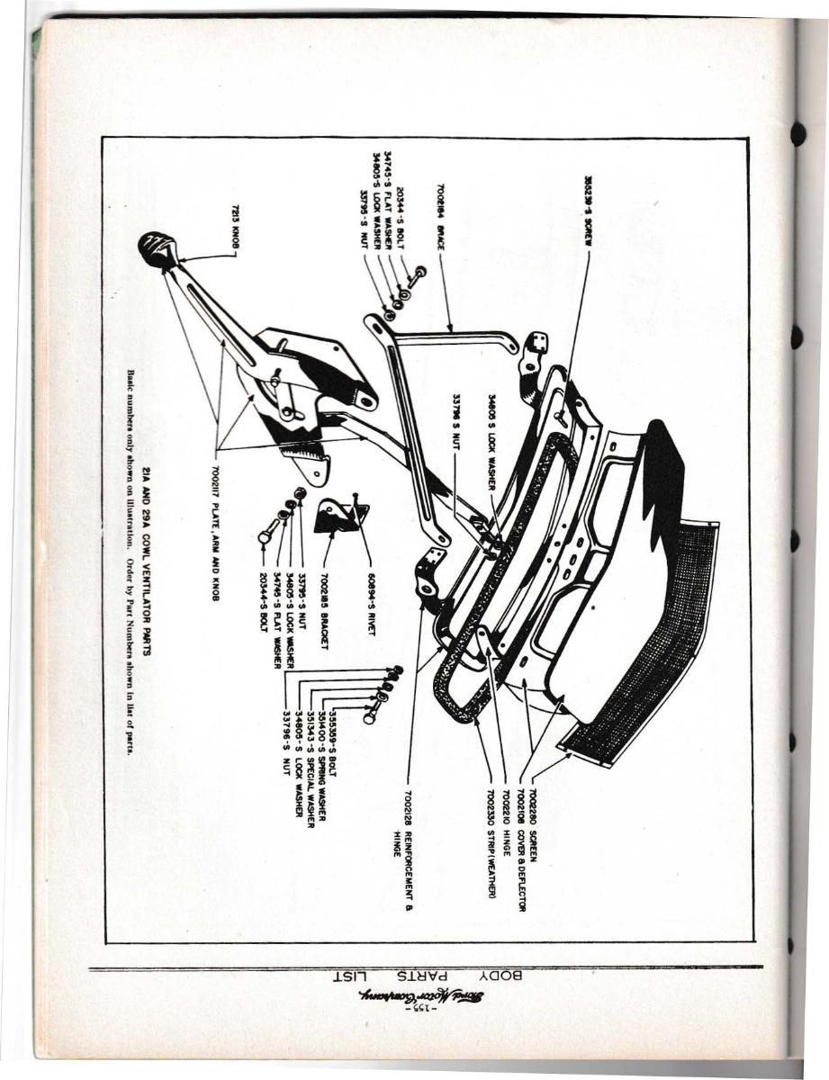

what's better than a brick is a screw jack between a ceiling joist and the cowl cover. I've tried all u guys said, and I'm still having trouble making the cover come down flush. It still tends to nose dive in the front, leaving a small gap in the rear. I've taken the whole assembly out, apart, and inspected for wear, to no avail. If I could see an assembly diagram, maybe I'll find something obvious (or Not). either way, if I take my coupe out in the rain , my feet will get wet.

The cover's not bent. It comes down evenly and seals under pressure. It's when I tighten up the 4 bolts for the cover and the other 4 bolts for the cover plate that it goes out of whack. I'm searching for a diagram to identify parts to see if my assembly is incorrect or bent or something else.

Here is a drawing of the 1942 cowl vent mech. It is very similar to your 41 mechanism. If the front end if the cover is dipping when you tighten the bolts, something is bent, either the cover or the bracket that it bolts to. The handle should not be in the fully closed position when you adjust the cover and snug the bolts up. Tom
| 41fatty | -- 09-17-2024 @ 6:29 AM |
Thank you TomO, this is what I'm looking for, as I have a chassis manual but not a body book. i will post my results.
