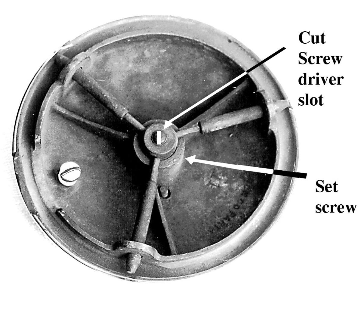

You have to remove the headless bolt at the rear of the cylinder ( many grind a screwdriver slot in the head) and take the brass cap off, then the three locking fingers can be removed. There is a special screw on the side of the cylinder through the casting which also has to be removed. Then the cylinder can be pushed out of the hole. In most cases there is NOT a key code on the lock cylinder or the brass cap that was removed, but do look carefully. Originally the glove box lock cylinder (if you have one) and the spare tire lock were keyed alike. Send the lock cylinder and foot ball shaped key blank and glove box key (if you want the cylinders to match) to one of the lock experts on fordbarn.com. Either John or Phil. This message was edited by 40 Coupe on 1-26-23 @ 4:49 AM

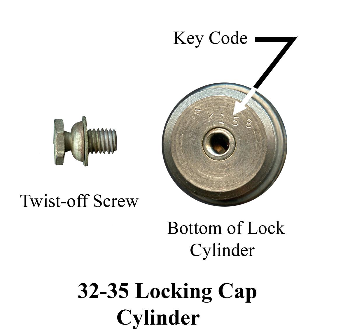

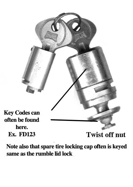

Here's some images to supplement 40 coupes description
