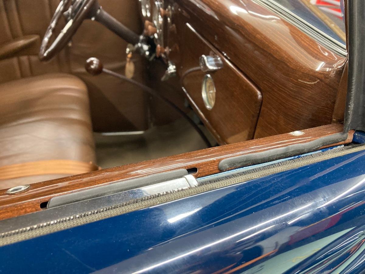

Gentelmen, I am not sure what rubber, bumper , whiskers, felts are supposed to be on the window side of the top door molding . I am pretty sure what is in there now is not correct - are there interior window felts like the closed cars ? Thanks, Chris
| v8er | -- 11-07-2022 @ 5:06 AM |
The molding and the rubber bumpers shown are the '35 style. The '36 cabriolet molding (with no oval holes) used a full length "fuzzy" strip held on with clips.
