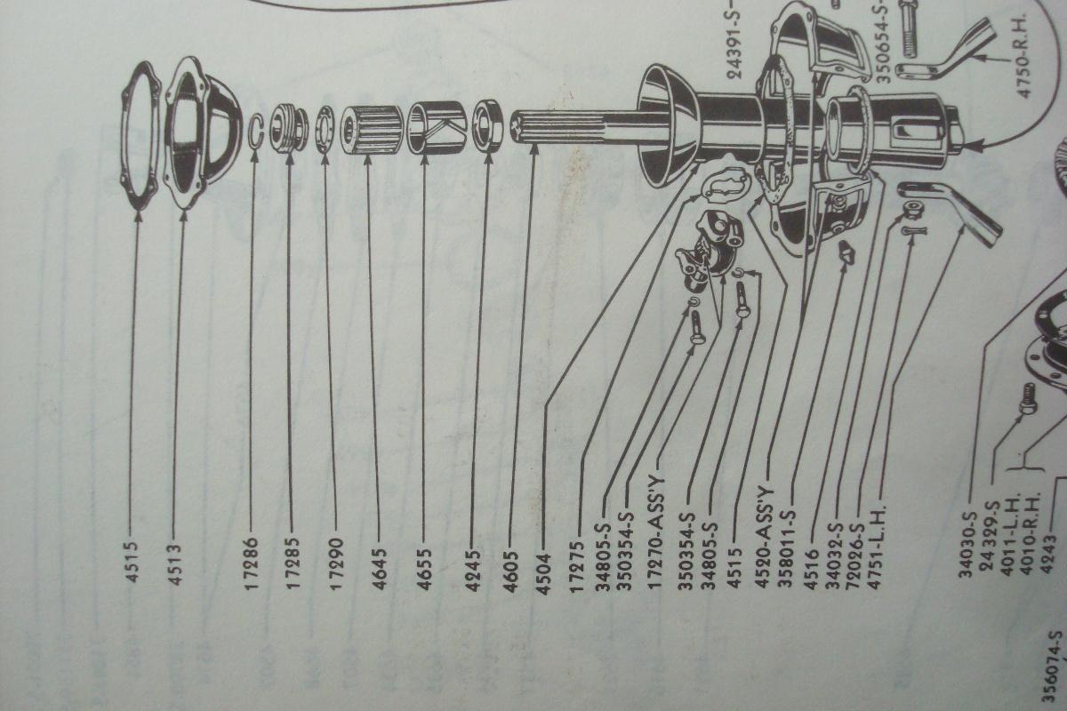

  what is the reassembly order of all parts relative to the snap ring. Thanks for any help you can give me.

not knowing what year, this from 1935-48 pass and 35 41 comm
this may help, out of THE FORD GREEN BIBLE
see PHOTO
mY 2 CENTS 1937 Ragtopman

  Thanks for ;your speedy reply. The picture is exactly what I needed. Have a great day
