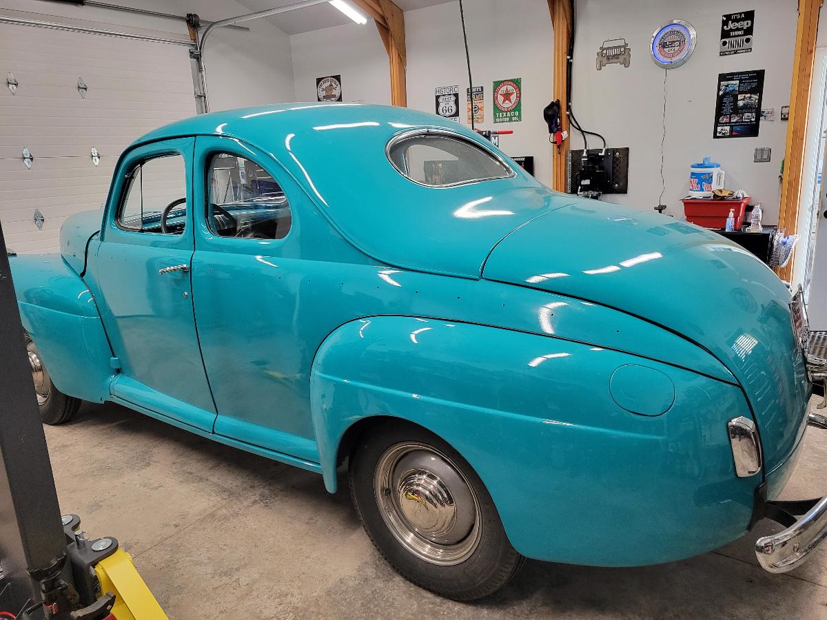

  Are the 41 coupe and convertable rear quarter panel moldings the same.
41-42fordadvisor    -- 06-07-2022 @ 5:24 AM
  The sedan coupe and the convertible use the same quarter panel moldings. The model 67 and model 77 coupe quarter panel molding are different. The convertible and sedan coupe quarter panel molding part numbers are 11A-7629034 for right side and 11A-7629035 for left side. The model 67 and model 77 coupe use part numbers 11A-7729034-A for right side and 11A-7729035-A for left side. Fred Killian
my41    -- 06-07-2022 @ 8:41 AM
  could you call me I trying to buy some trim on Ebay and want to be sure it will fit 406-396-0495
Thanks alot!
TomO    -- 06-09-2022 @ 7:06 AM
  The convertible trim will not fit your Coupe. You will need the longer trim for a "business" or "short door" coupe.
