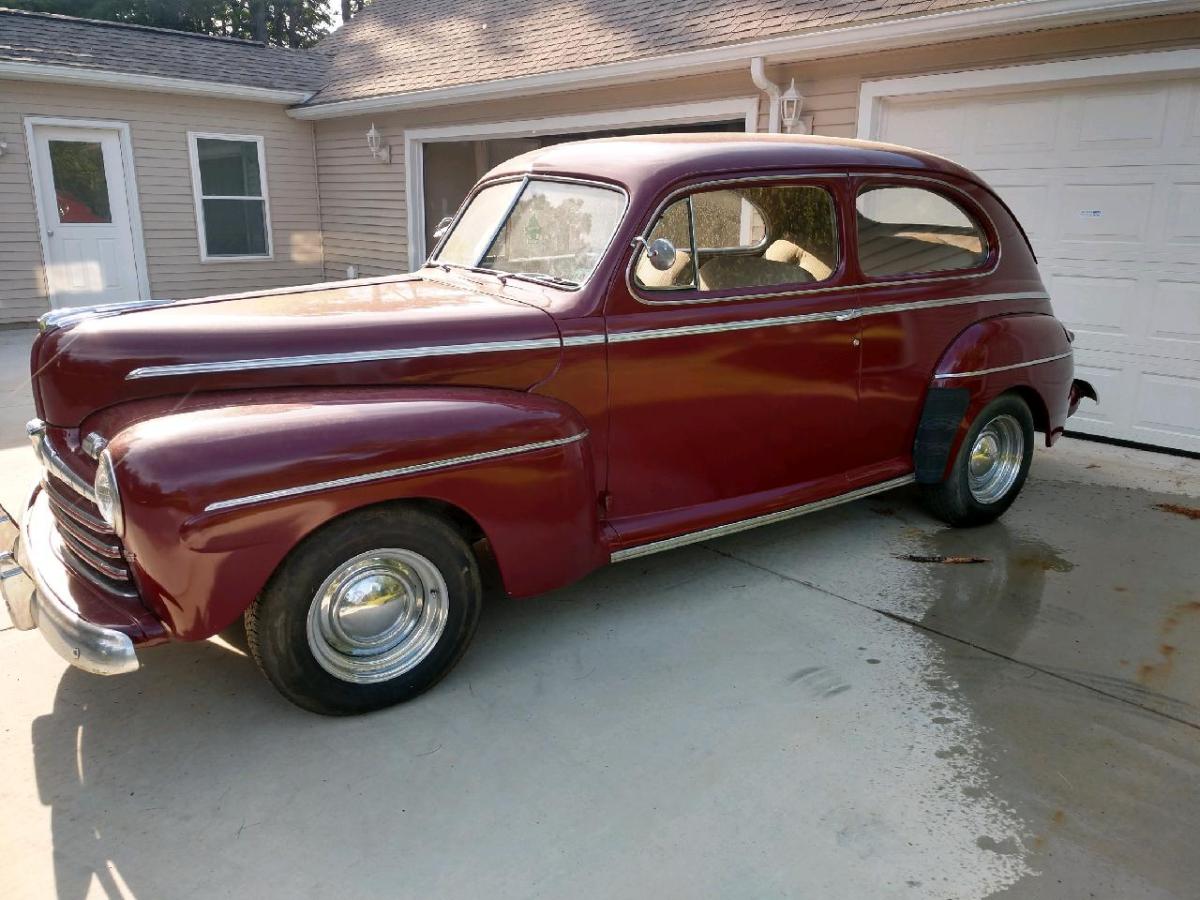

  Hello, new member here with a simple question. I bought a 46 Ford 2 door sedan and the choke and throttle rods are not connected to the carb or at the firewall. Does anyone here know what length these are? I have a friend who has a bunch of pieces but has no idea what length a 46 should have.
Thanks,
Dale
TomO    -- 04-28-2022 @ 2:17 PM
  For A 6 cyl. car the choke cable is 43" and 35" for the 8 cyl.
The throttle cable is 53" for the 6 and 38.5 for the 8.
