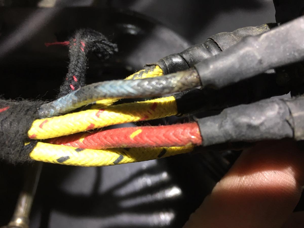

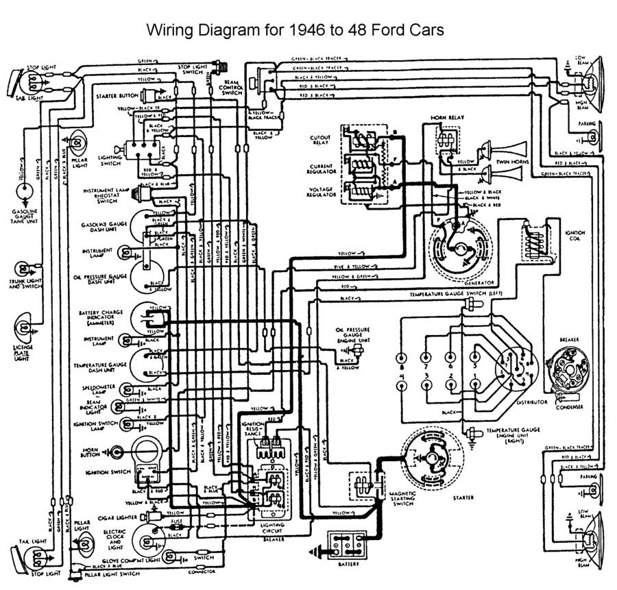

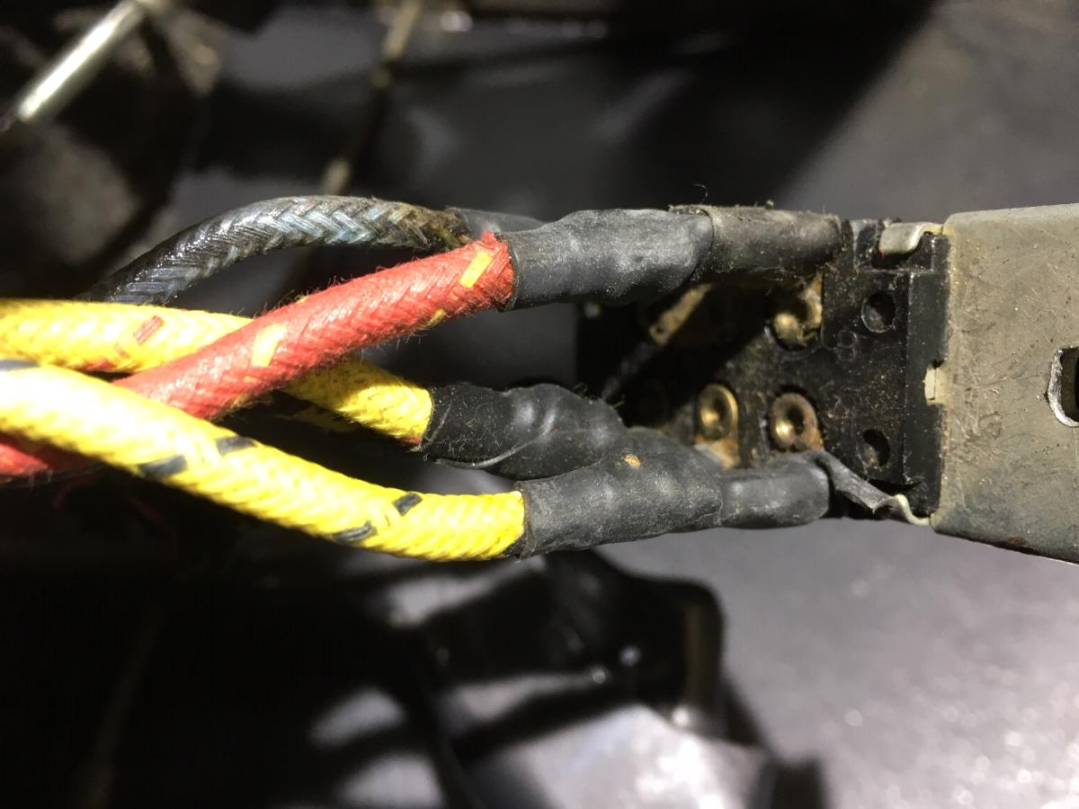

I am installing my new harness and the legend has wires going to terminal B1 and others to B2. This is besides the wires for H, P, R. My switch has two terminal B but there is no designation which is B1 and B2. My question does it matter which is B1 and which is B2? Thanks in advance for any input.
| 51woodie | -- 01-14-2021 @ 5:42 AM |
James. Here are pictures of the connections on the light switch of my '46 Coupe. Should be the same as your '47. Also attached a wiring diagram, that I hope is clear enough to read. Darned pictures got turned sideways! But between the pics and diagram, you'll be able to figure it out. This message was edited by 51woodie on 1-14-21 @ 5:45 AM
