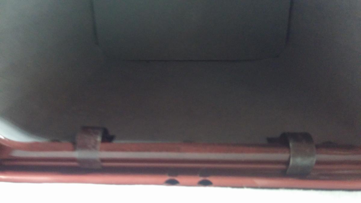

I'm putting my 37 slantback dash back together after having it painted. My problem is the glove box door will not stay closed. I have the spring clips installed but they don't seem right. I took pictures at the time of disassembly but can't find them. Any help would be appreciated. John

I does not look as if the springs are installed correctly. They should extent to the lower lip of the door.

Forty, Thanks for getting back to me. I'll move those hinges to see if that works. Thanks again. John

That was the issue. Spring clips were not in the correct position. Thanks agsin. John
