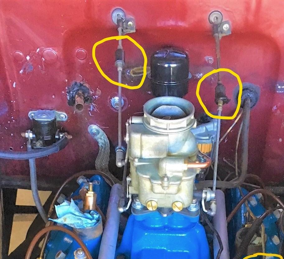

| TomO | -- 05-18-2020 @ 10:18 AM |
Does the knob on the dash go back in or stay in the position that you set? If it goes back in, check the accelerator pump, it should not have spring tension for the first 3/16" of the down stroke. Some people put a helper spring under the pump and that could cause the throttle cable to move due to the increased spring tension. You could increase the tension on the cable by removing the cable from the dash and putting a small crimp at the part of the cable that the knob shaft fits into. If knob stays the same as you set, then check the flex joints. The rubber in them could be deteriorated enough to allow the throttle to close. The fix is to replace the joint. The rubber grommets that Jay was talking about were used on the 1940 cars that used rods and not a full cable to the flex joint. Tom
| 51woodie | -- 05-18-2020 @ 1:55 PM |
Tom If I pull the throttle out and let go, it goes back in. The throttle linkage is stock with no extra springs. I do have a set of flex joints, but not sure how to change them. Grind old ones off and crimp new ones on?

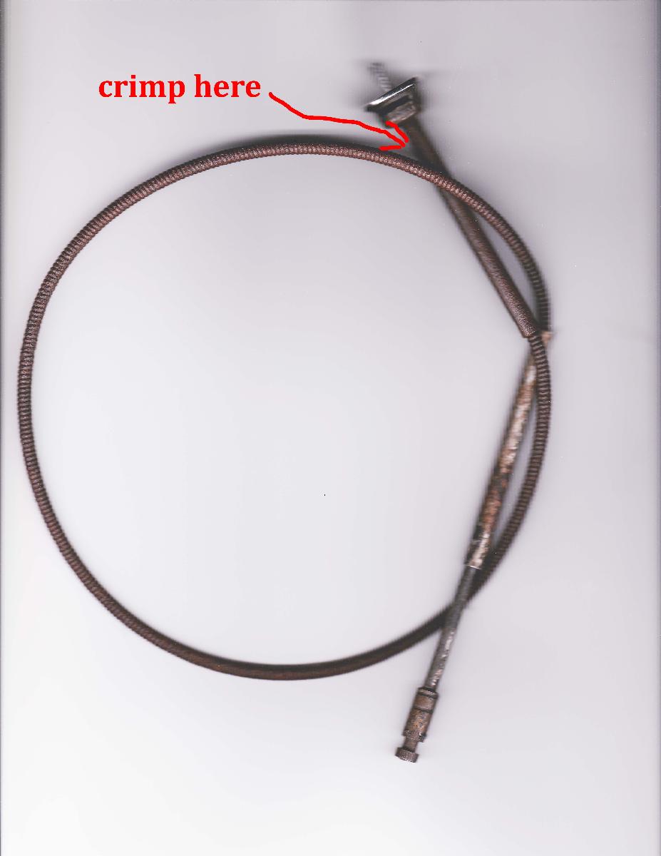

| TomO | -- 05-19-2020 @ 8:24 AM |
You can do that or just do like I did, remove the old rubber ones from the cable, remove the stubs on the new ones from the rubber and insert your cable into the new rubber. Because your knobs are going back in, I would remove the cables and tighten the action by crimping them as shown in the photo. Be careful to not make them too tight Tom
| 51woodie | -- 05-19-2020 @ 4:14 PM |
Tom. Thank you for your replies and information. From looking at the picture you included, does the rubber portion "snap on/off from the groves in the linkage/cable ends, or is the rubber moulded on to the ends? Right now, one of the flex joints has a tywrap on one end of the rubber section, so that makes me think it must have come apart at one time on a previous owner.
| TomO | -- 05-20-2020 @ 6:53 AM |
The rubber doesn't exactly "snap" off. It took quite a bit of effort to remove the 2 crimp on ends from the rubber. I did this in 1975 and can't speak for the current replacements, but they were not vulcanized on the stubs back then. If your replacements are vulcanized on to the stubs, then you will have to go the cut and crimp route. Tom
| kubes40 | -- 05-20-2020 @ 6:59 AM |
The rubber joints, while appearing to be in poor condition, are not effecting the correct operation. The grommets in the instrument panel are. Replace those and you will be pleased with the outcome. Carpenter sells the kit, around $25 if I recall correctly. Replacing the rubber joints is a bit of a task as TomO suggests. If you decide to replace them, remove the rod (assembly) from the car and R&R on your bench. I might suggest you cut through the old rubber carefully to remove it. Before installing the replacement joints, be certain each end of the rods are clean. A quick spin with a wire wheel will do the trick. Use a little lubricant that will dry (WD40 as an example) on the rubber and push it over the respective end. It'll snap in to place. Carpenter sells those as well. Mike "Kube" Kubarth This message was edited by kubes40 on 5-20-20 @ 7:03 AM
