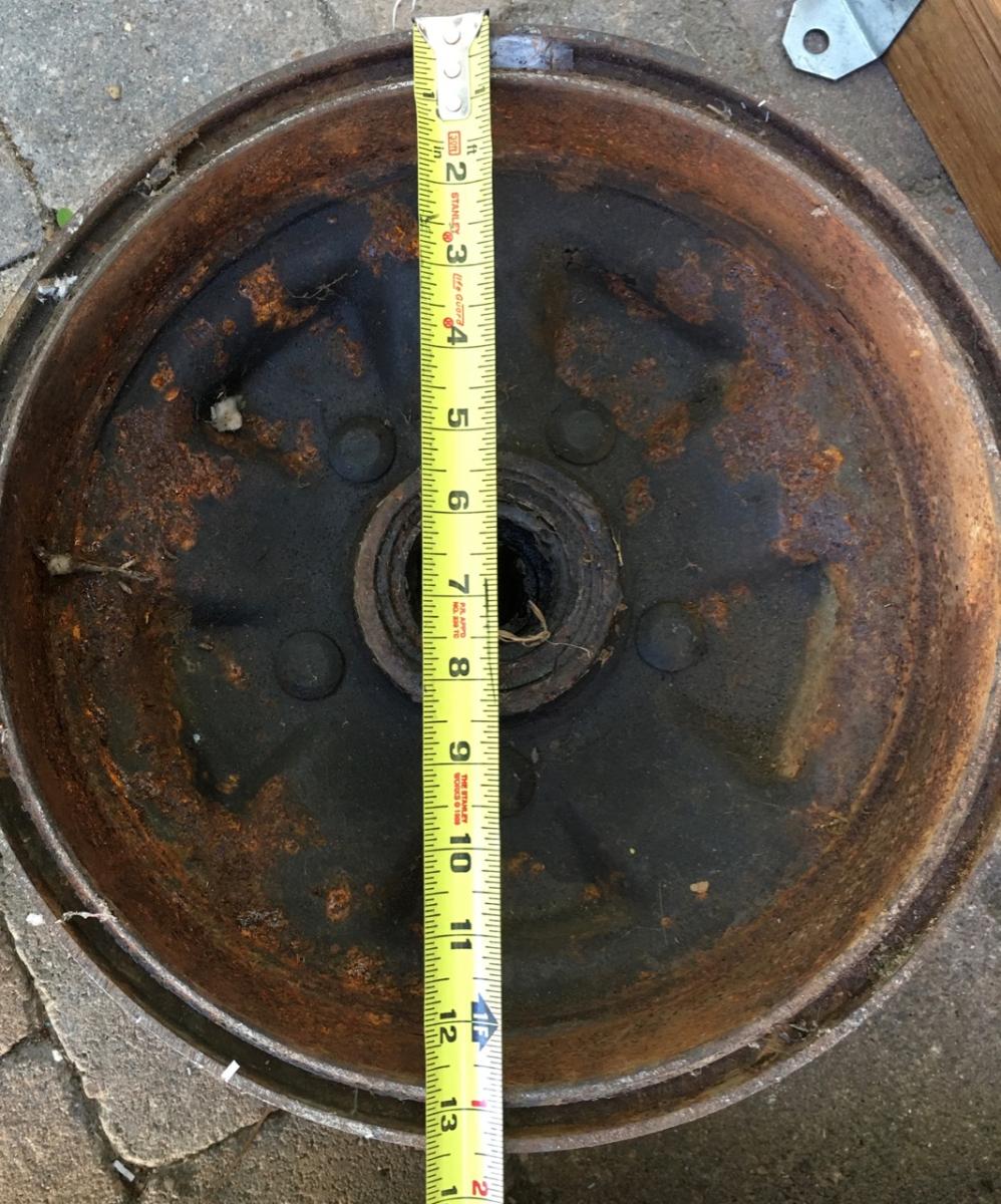

1936TWC    -- 04-03-2020 @ 1:14 PM
  What would outside diameter of a F1 11 inch drum be? Trying to setup desired rim with brake drums. Did purchase 1953 front backing plates.

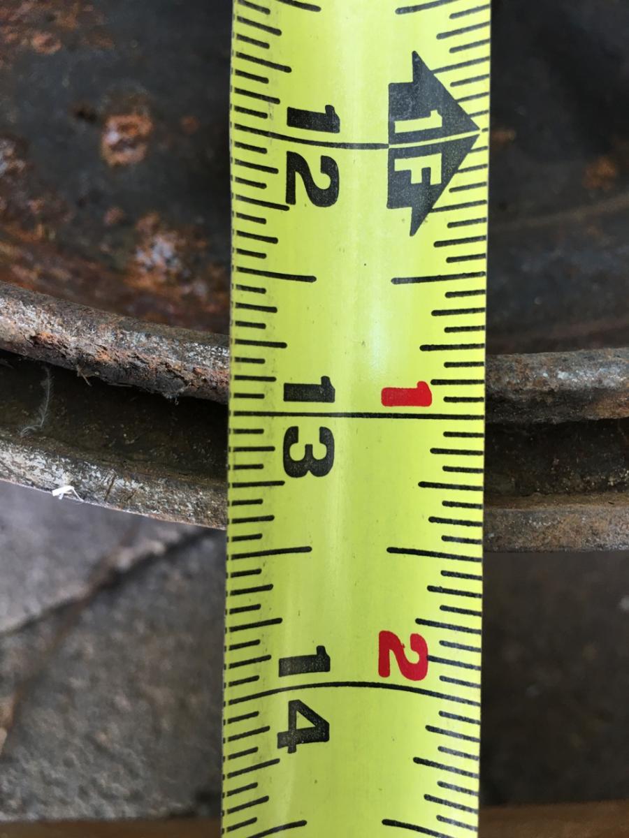

1936TWC    -- 04-14-2020 @ 12:11 PM
  Outside diameter is 12.75 inches
