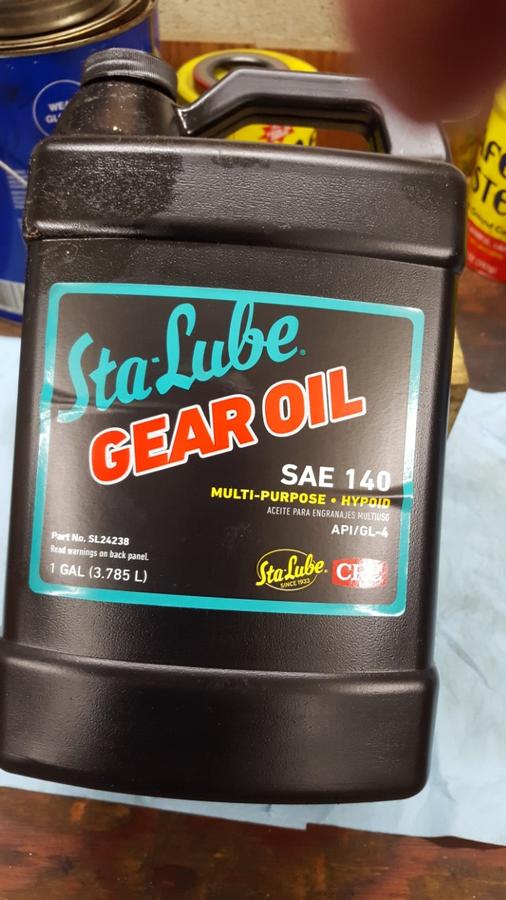

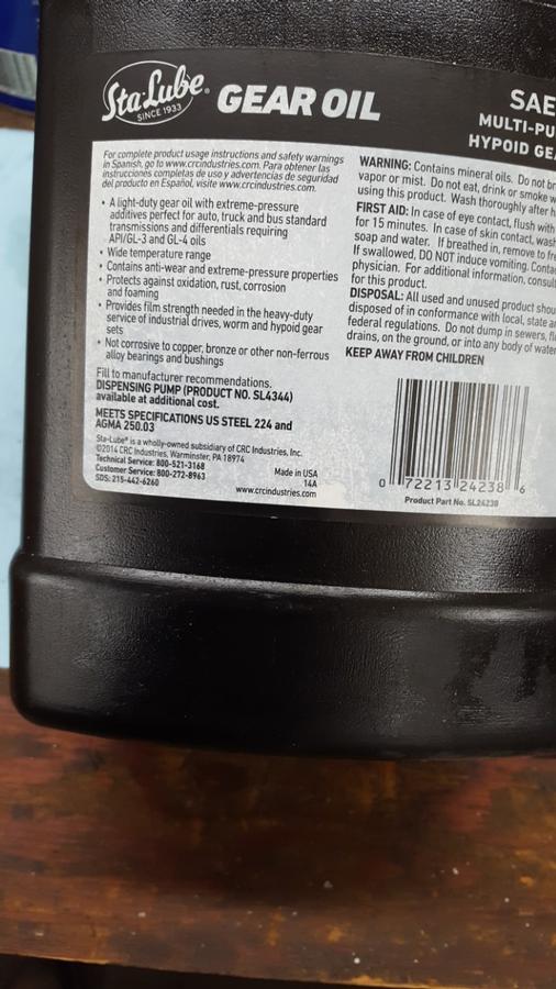

The owner's manual for my 1939 Tudor specifies "Mild Extreme Pressure Gear Oil: Winter S.A.E. Viscosity 90. Summer Viscosity 140." I use Sta-Lube SAE 140 API/GL-4. I do not drive the car in winter. Larry
| ken ct. | -- 12-30-2019 @ 5:29 AM |
GL -4 is OK for rear end as no brass parts in them BUT NOT OK for Tranny as their are in tranny. ken ct.
