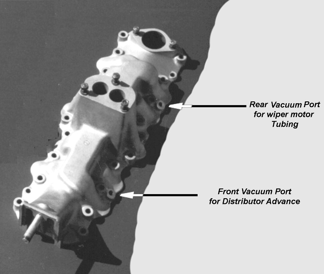

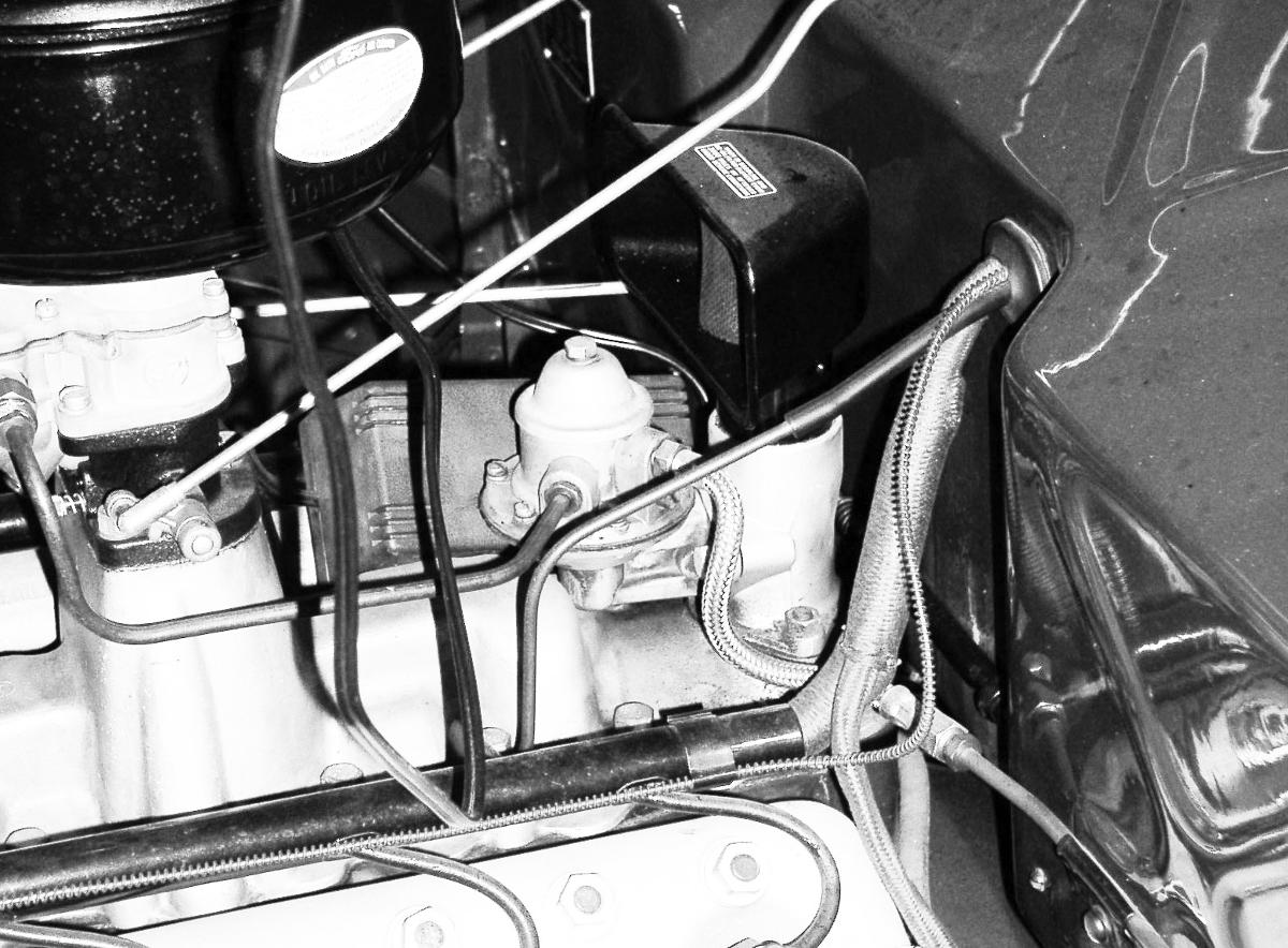

  Where does the vacuum hose connect on the engine and where does it come through the firewall?
Al C.
40 Coupe    -- 12-26-2019 @ 4:22 PM
  The wiper hose connects to the intake manifold on the drivers side near the rear it is between the rear two intake runners. It passes through the firewall in the large oblong hole with the main electrical wiring harness.
Don Rogers    -- 12-28-2019 @ 5:03 AM
  Here's some photos to augment 40 coupes description.
