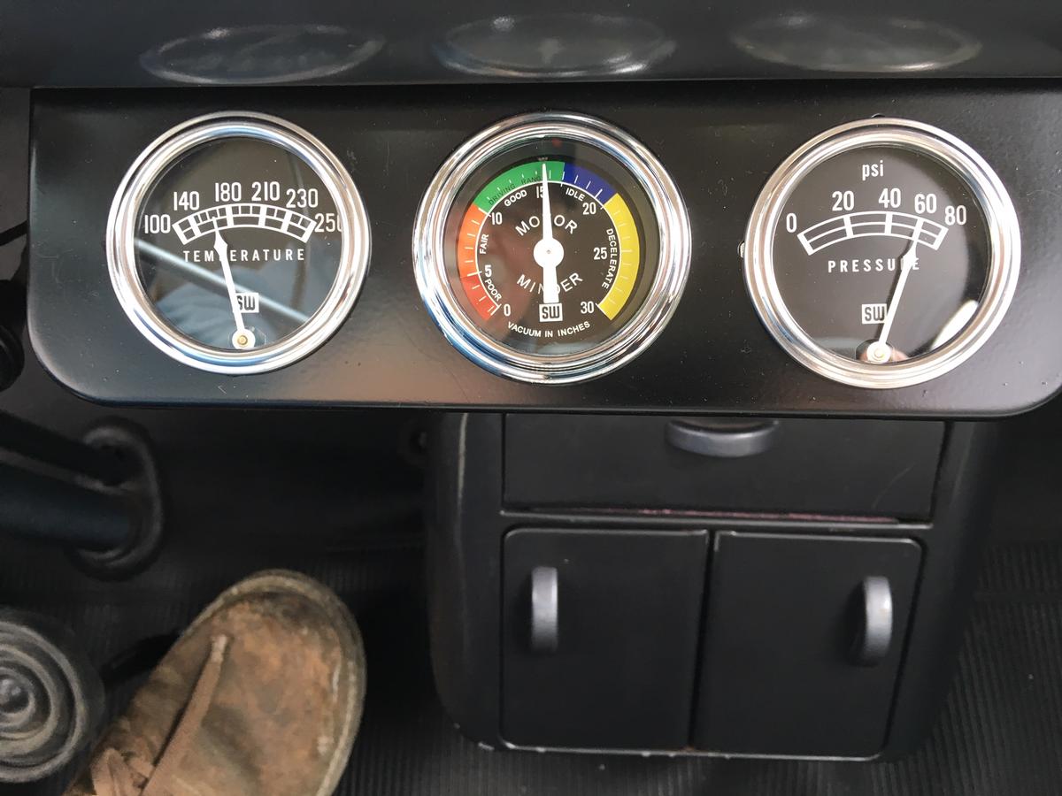

I worked hard and learned a lot about the gauges in my '46 Coupe, in order to get them all working. The previous owner didn't worry about the gauges working I guess. Even though they all work now, with some semblance of accuracy, I still installed a set of mechanical gauges. They may look ugly to some "original people", but they do give a good measure a comfort to me at least, knowing what is actually happening on the front side of the tin. Merry Christmas and Happy New Year to all. Left pic is at 55 MPH and right pic is at idle. This message was edited by 51woodie on 12-25-19 @ 4:32 AM
