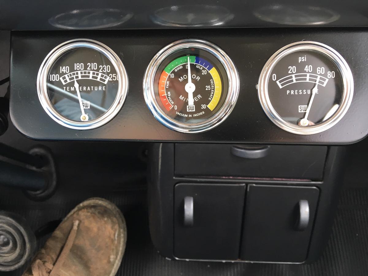

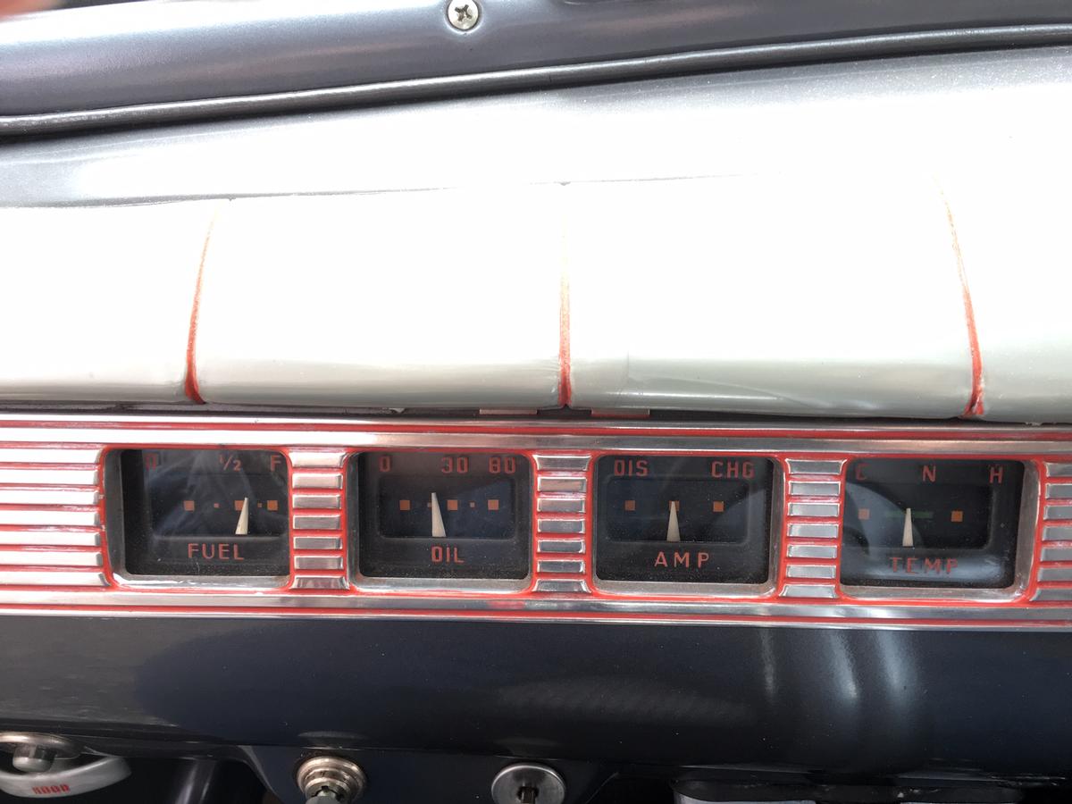

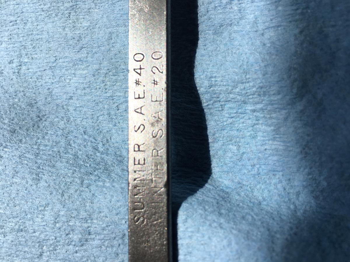

The 59ab in my '46 Super Deluxe was obviously rebuilt at one time, as it has adjustable lifters, and what must be an 80lb pump. I use Rotella 15-40 (see dipstick) and the attached pics tell the story on the pressures I have. An 80lb sender feeds the dash gauge, and the dash gauge reads lower than the mechanical gauge. As someone said, "If it has any pressure showing, don't worry about it".
