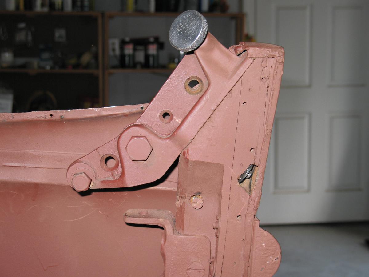

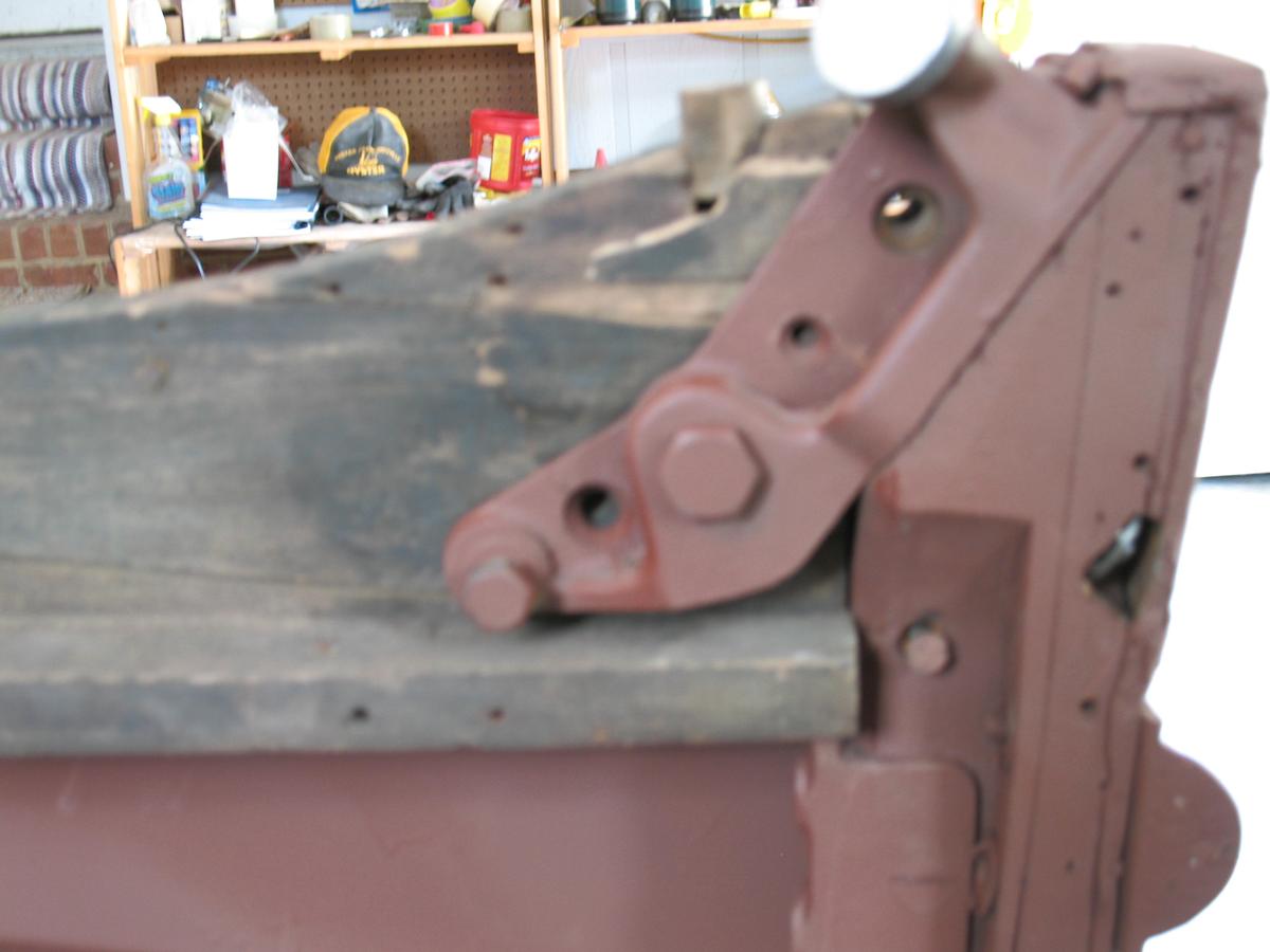

I have just installed a new wood belt rail on my convertible sedan. I see where the top iron attaches but I seem to be missing some hardware or a bracket. I have attached some pictures . Can anyone help me with this. Thanks.
| 35fordman | -- 04-24-2019 @ 7:15 AM |
Yes there is another bracket that mounts there. It is the bracket that holds the thumbscrew that lock the top mechanism in place.

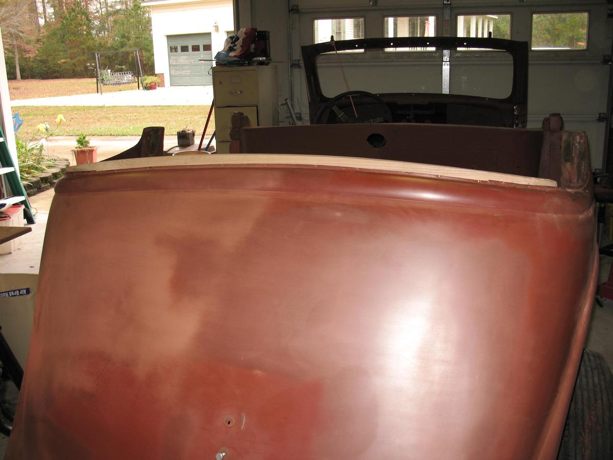

Thanks so much I doubt if I can find them but at least I know what I need and can continue with my project. I will also attach a picture of the amount of belt rail exposed above the rear trunk metal to see if it looks about right. Thanks again.
| 35fordman | -- 04-24-2019 @ 11:57 AM |

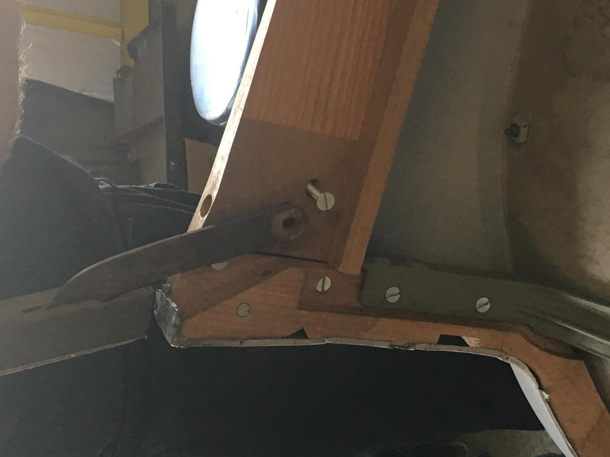

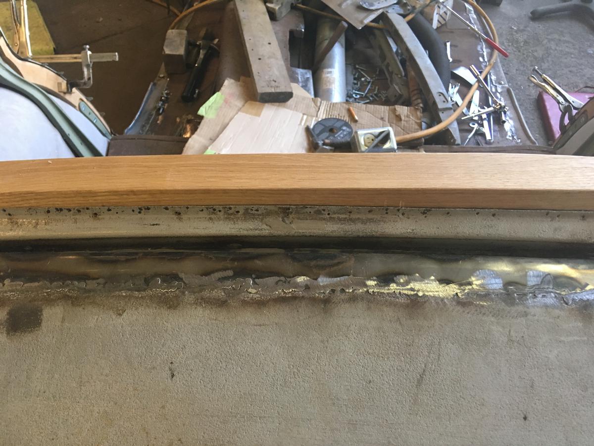

It looks about right. Here is a picture of the rear belt rail when I installed it in my 35.
