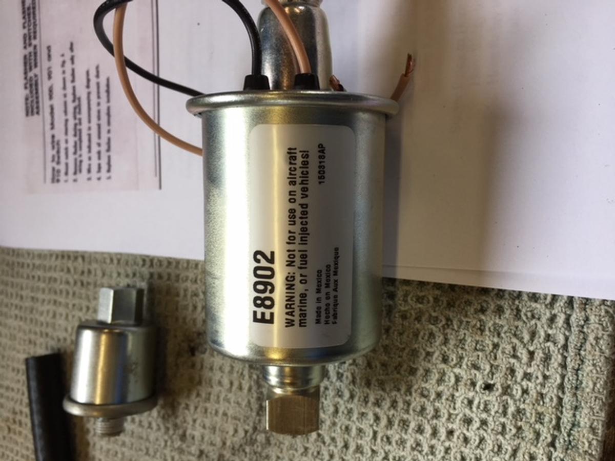

Can anybody suggest a 6 Volt Electric Fuel Pump with only 3 psi. for a 1940 Ford Standard. Thanks for any help Thank You, Harry8750
| ronford | -- 04-19-2019 @ 6:51 PM |
You might check out an Airtex E8902. May be available at Auto Zone. Ron
| Model B | -- 04-19-2019 @ 7:39 PM |
Ron is correct. You might try Amazon also. They usually trend at around $30. Good luck, Pat
| 51woodie | -- 04-19-2019 @ 7:40 PM |
I installed a 6 volt Airtex E8902 on my '46 coupe in 2018, which I bought from Rockauto for $32.00. I only use it for "priming' after the car has sat for a number of days. It works well for me, has the right pressure, and is a "flow through" design, which allows the engine fuel pump to provide flow to the carb when the engine is running. I also used the metal fuel filter with threaded connection to the inlet of the pump.

Hello Harry. The low-pressure Airtex E8902 installed on our '36 Ford works just fine. It is controlled by an on/off toggle switch under the dashboard. Mounting it on the side of the chassis close to the gas tank is important, in my opinion. The pump is protected with a cover plate made from a bread pan filched from my wife's pantry ........ can post a photo if that would help you.
