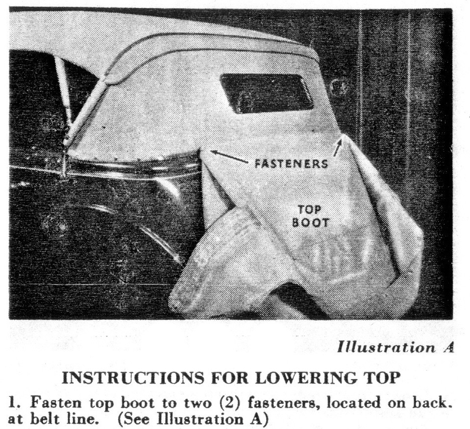

Does anyone have access to a video or any instructions on how to install the boot cover on my 36 Phaeton? Thank You.
| Don Rogers | -- 03-02-2019 @ 7:03 PM |
Here are 3 images from Fords Phaeton top lowering instructions

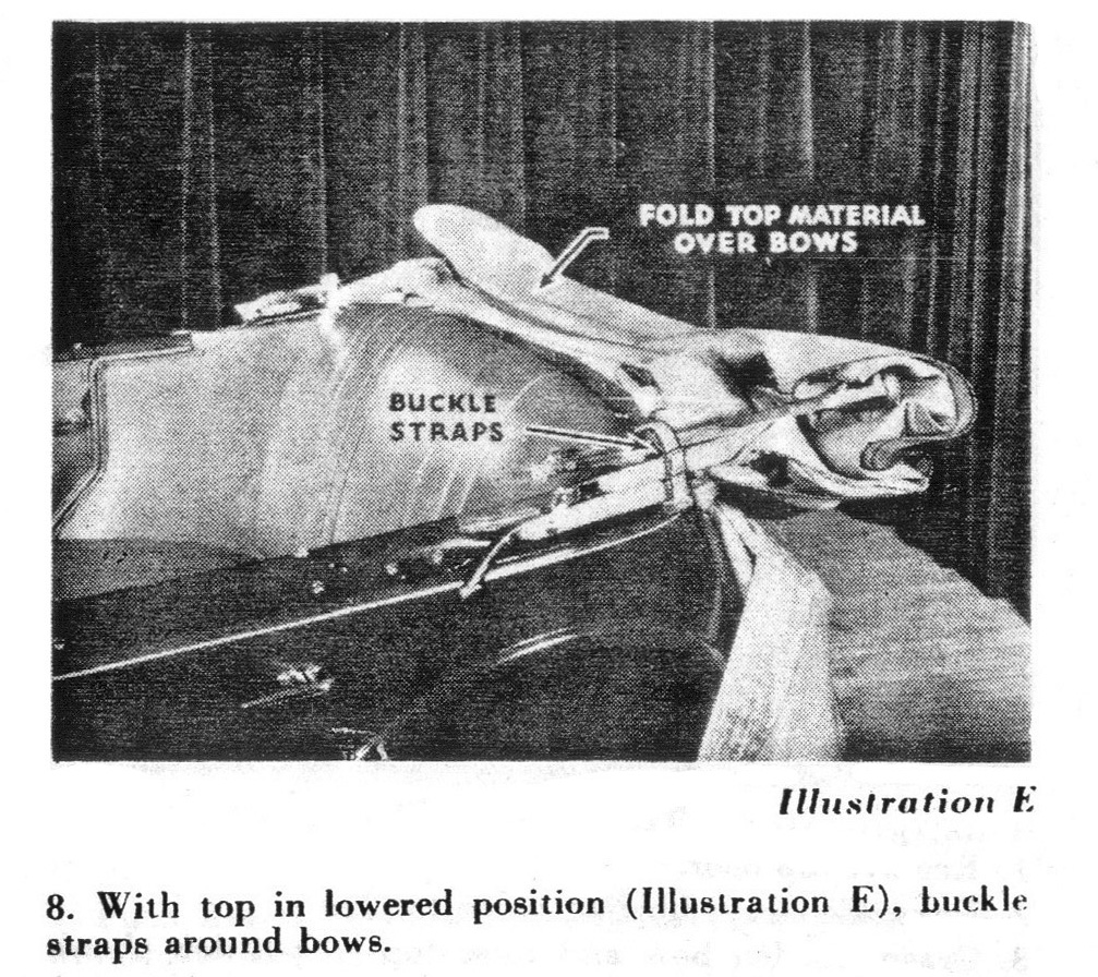

| Don Rogers | -- 03-02-2019 @ 7:05 PM |
image 2

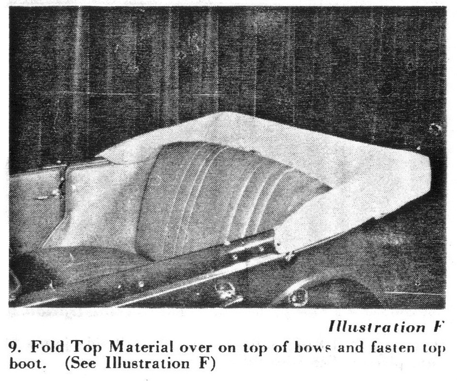

| Don Rogers | -- 03-02-2019 @ 7:06 PM |
Image 3
| Lobo | -- 03-03-2019 @ 9:18 AM |
Thanks Don very helpful
