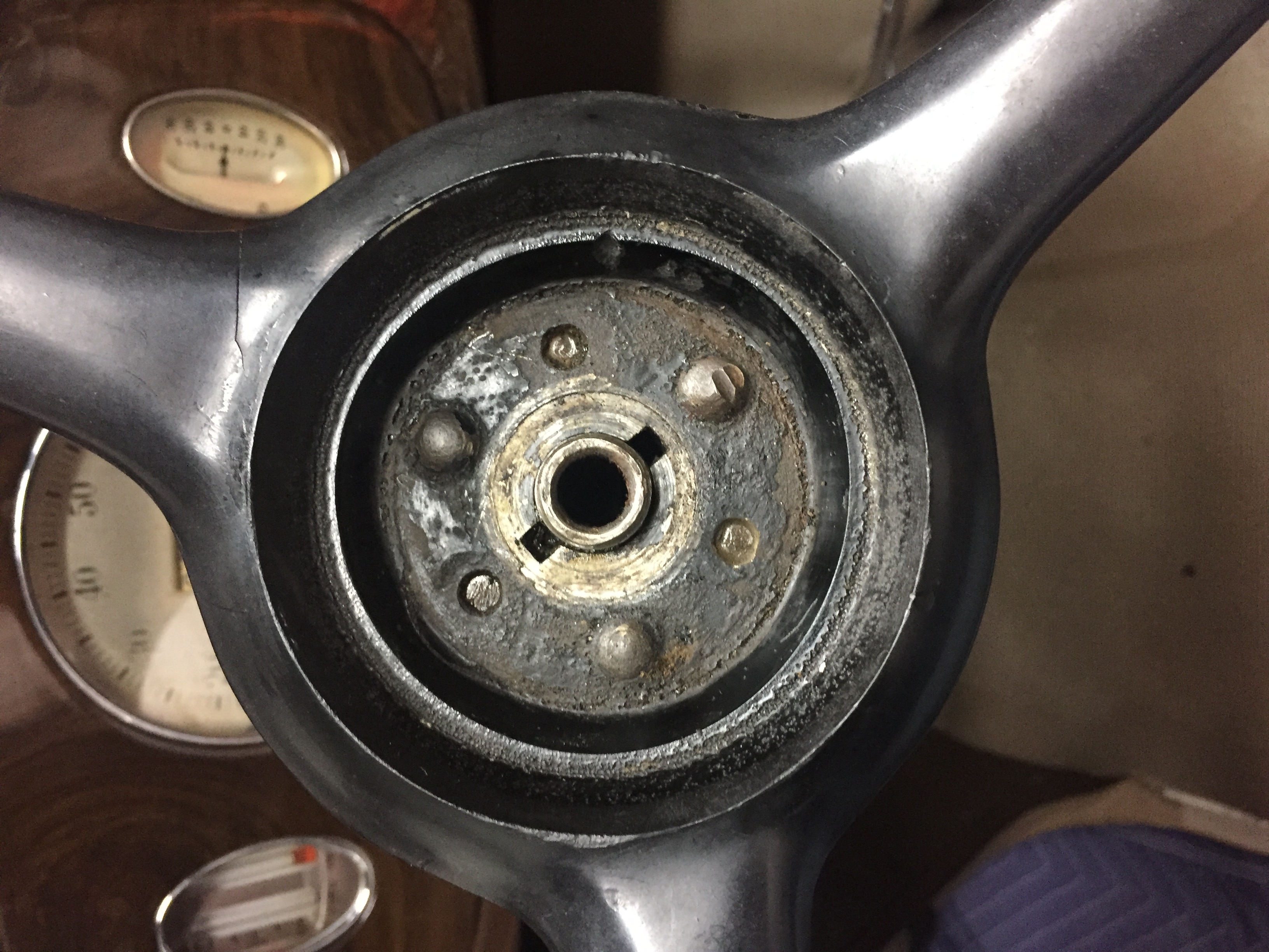

If you have started and you can take a picture of the wheel where the nut holds the wheel there is a long shot that someone drilled a couple of holes for a modern puller? The attached picture shows the area I want to see, in this case without the extra holes. If these holes are not there then it may be time to look for an original steering wheel puller. If the steering wheel is loose you may be able to remove it without a puller (small chance). Be careful it is easy to damage the threads on the steering shaft. Get your answers before you get out the hammer (especially to MG) , these parts are easy to damage and getting hard to find. Charlie Stephens This message was edited by CharlieStephens on 2-3-19 @ 8:23 PM
| Amigo4 | -- 02-04-2019 @ 7:31 AM |
Thanks for your prompt reply. A picture is attached, no holes. The steering wheel is not even thinking about being loose. Won't hitting the rod with a hammer damage the bearings or gear in the steering box? I have no idea where to search for an original wheel puller. Dave

"Thanks for your prompt reply. A picture is attached, no holes. The steering wheel is not even thinking about being loose. Won't hitting the rod with a hammer damage the bearings or gear in the steering box? I have no idea where to search for an original wheel puller. Dave" I don't like the hammer idea as you usually mess up the threads on the shaft. Try contacting your local V8 Club Chapter and see if they have one to loan to members, they may rent it to a non member. If still no luck try a wanted ad here and on fordbarn.com. You could probably start with "want to rent". Try contacting VanPelt, they don't show one for rent on their site but you never know until you ask, http://www.vanpeltsales.com/FH_web/flathead_home.htm Charlie Stephens
