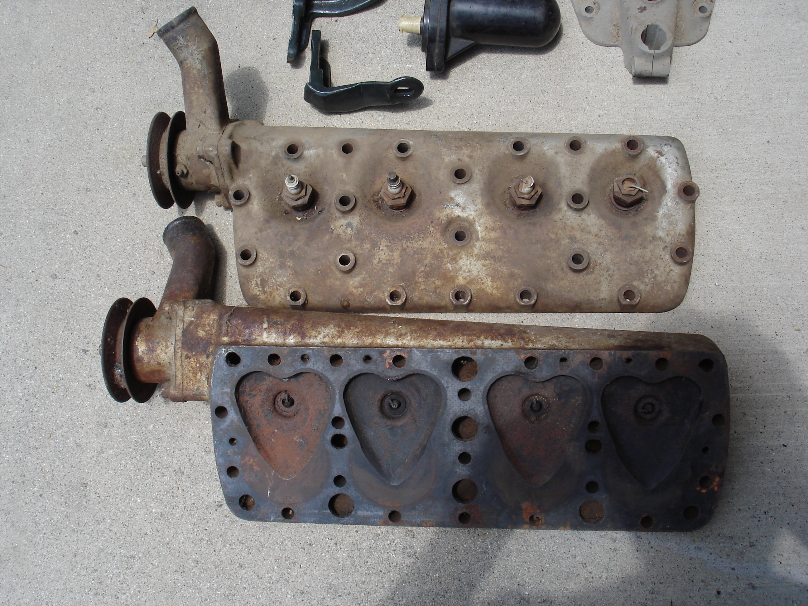

All '32 production heads were cast iron and the V8 versions had V or heart-shaped combustion chambers as shown in the photo below. Most '33 V8 aluminum heads had no cast-in part numbers. They were added when cast iron heads were released for use on big trucks and some commercial vehicles.

Bingo! The heads I have look exactly like the ones in your photo, heart shaped chambers, 7/8 plugs. The heads I have are aluminum not iron. Could they be early 1933? Paul
