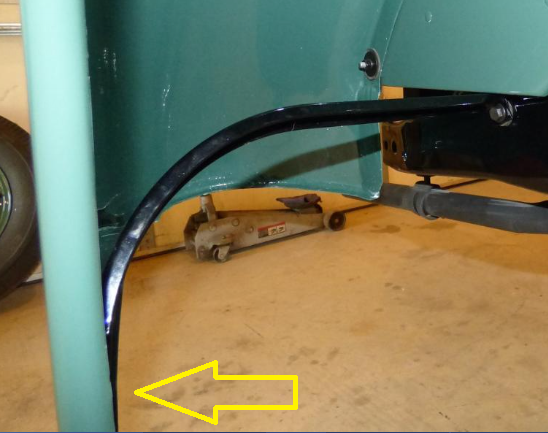

I have my Dad's 40 Pickup and the rear fenders are pretty mangled. I don't know how the fender brace should attach to the fender. Does anyone have a photo of the brace to fender mounting that might help me figure out how to repair this? If anyone is in the Twin Cities with a truck in decent shape, I'd be stoked if I could take a look at it. This truck has been in the family since '59 and was a working farm truck until '79 so its got lots of wear and tear and farmyard repair and seeing a physical example would be helpful. Thanks, Ralph

Thanks Tex. Unfortunately, I didn't see quite what I am looking for. I need to reconstruct the fender where the brace mounts. So I need to see a view from the inside looking in the direction of the arrow in the attached photo (taken from Mike Kubarth's post). I have 4 fenders and all are missing the original brace mounting area. Btw, that's some awesome progress! This message was edited by dommi7 on 12-20-23 @ 7:10 AM

There is a small tang on lower inside back of fender that the brace attaches to- later pickups had a carriage bolt going through the fender in the same spot with a sheet metal backing for strength.

Thanks F1 - I'm hoping someone can take a photo for me that illustrates the tab so I can reproduce it. I am replacing rusted out areas and I don't have a pattern to go by.
