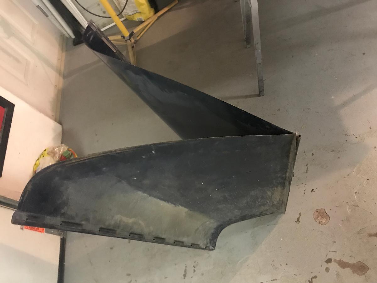

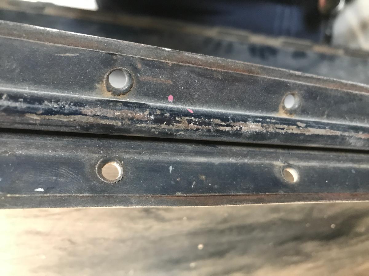

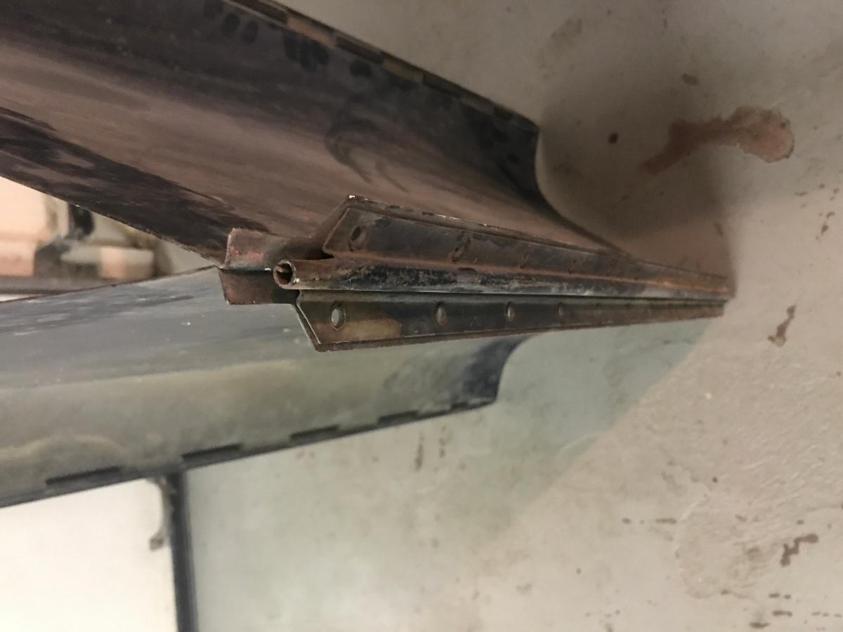

| Bonafide 36 | -- 09-14-2020 @ 3:00 PM |
Thanks, so to separate it will it slide apart length ways or from the side? It is not welded, the hood is stamped to the hinge. ( not sure what the process is called) the image should show it pretty good.
| nelsb01 | -- 09-14-2020 @ 4:13 PM |
Yes. If you look at either end of the hinge you will see that one side fits in the other. After years, you may have to do some work to get the ends so they slide out, as they maybe damaged.
